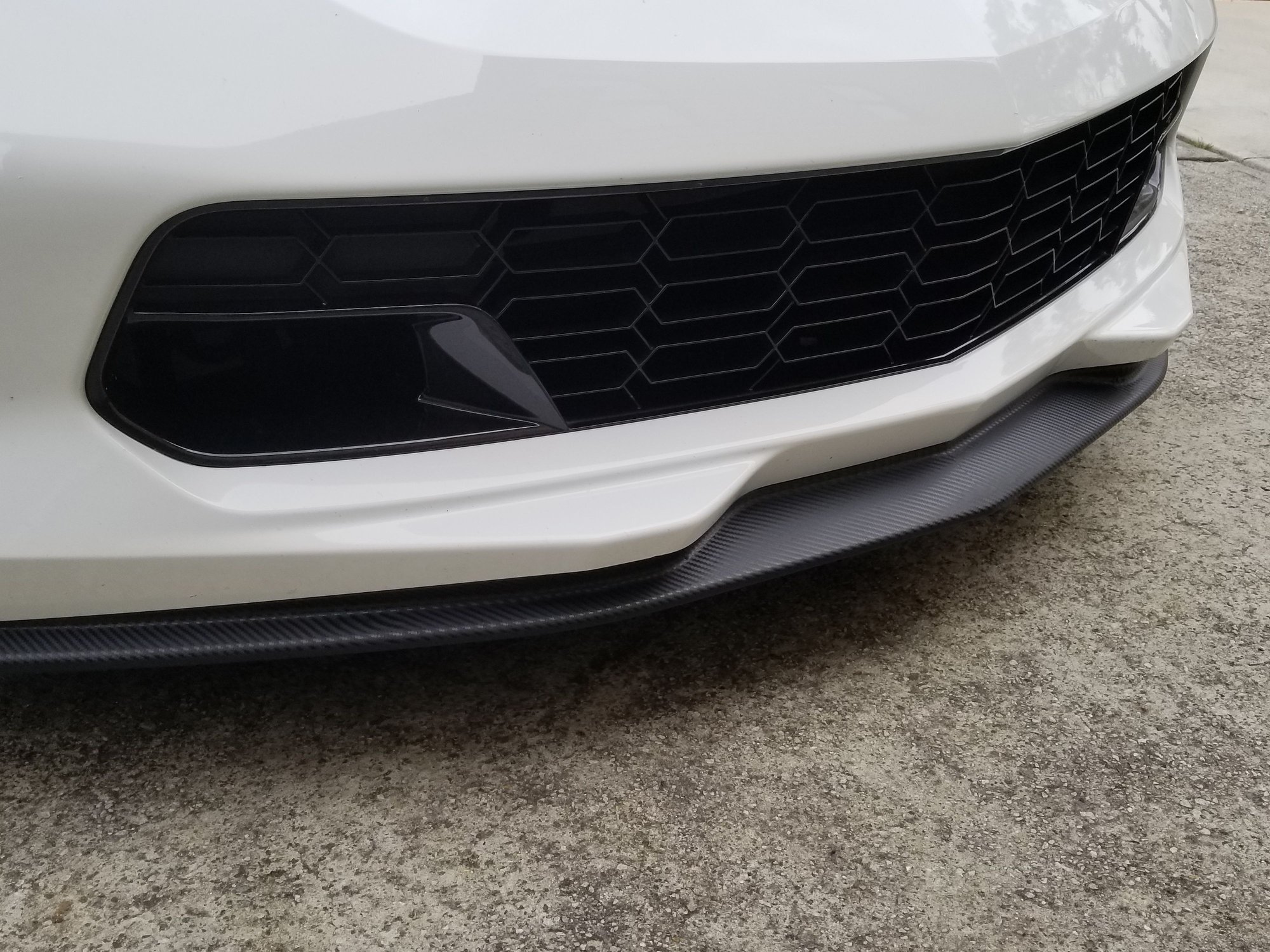

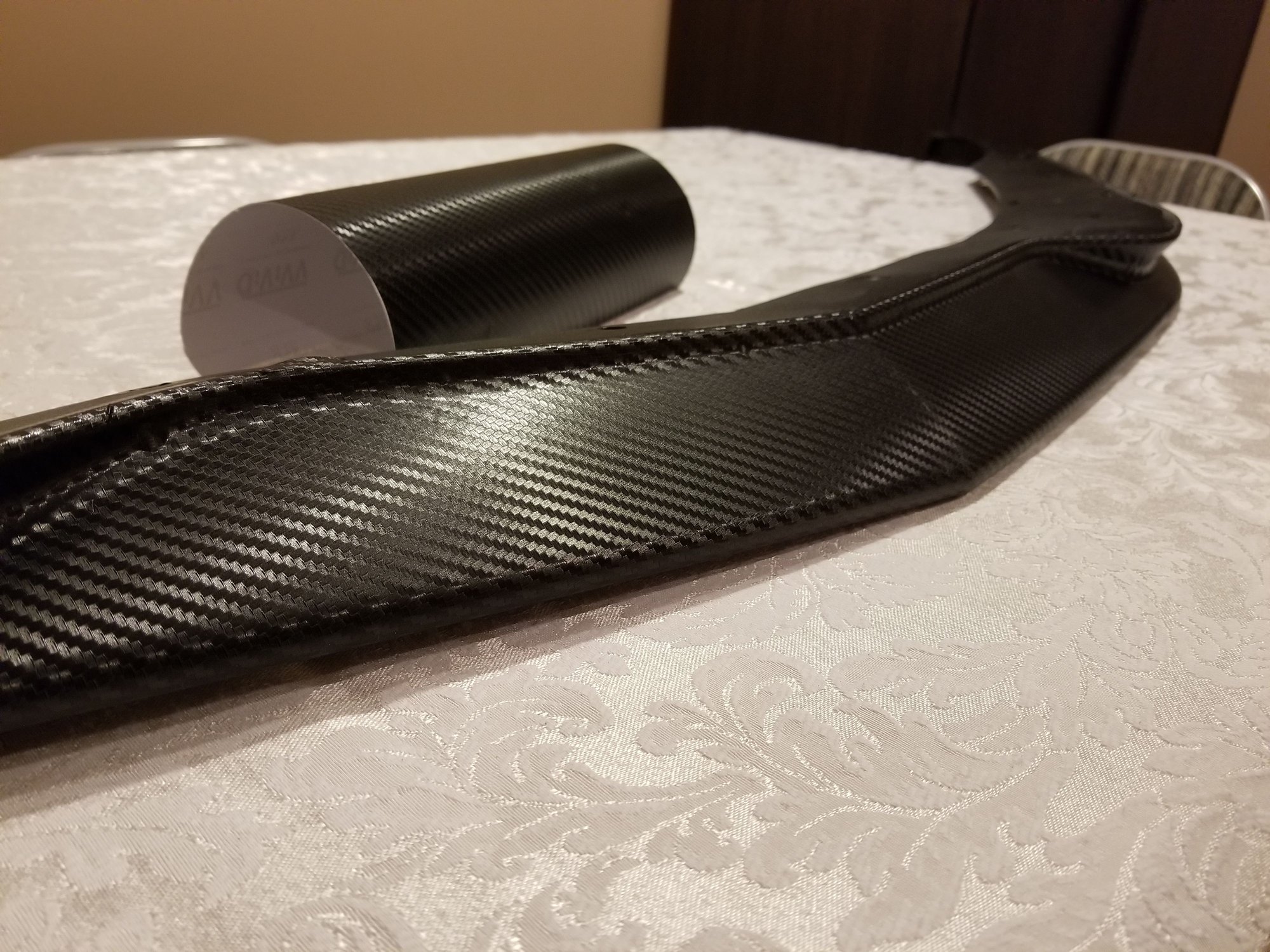

I am the guy who wrapped in CF ... never wrapped anything in my life and this was my first try

I did this a long time ago. The wrap was applied directly to the stage one splitter with the only prep being a good wipe down with a alcohol . I did it in two pieces to make it easier to handle as there is a lot of stretching, pulling and heating . When applying the second piece on the other side I was careful , making sure that the carbon fiber pattern lined up with the side that was already installed .
As far as how did it hold up .... I had a few "bubbles" pop up where the material lifted in the curve part , I just used a pin to create an escape and then hit it with heat and smoothed out the product
It lasted a long time ..... until I hit a curb bumper again as I don't have a front camera , which is exactly why I won't spend 1,000 on a real carbon fiber , the only damage was a few dollars of wrap
I wrapped it again .... so all I lost was a few dollars and some time
I will tell you it is a test of patience as you have to really work the material into spots it does not want to conform to ... lot of stretching , heating ( burned fingertips lol ) and lifting up to redo again . If you have time and enjoy a challenge .... its better than cracking a 1000 dollar splitter lol
