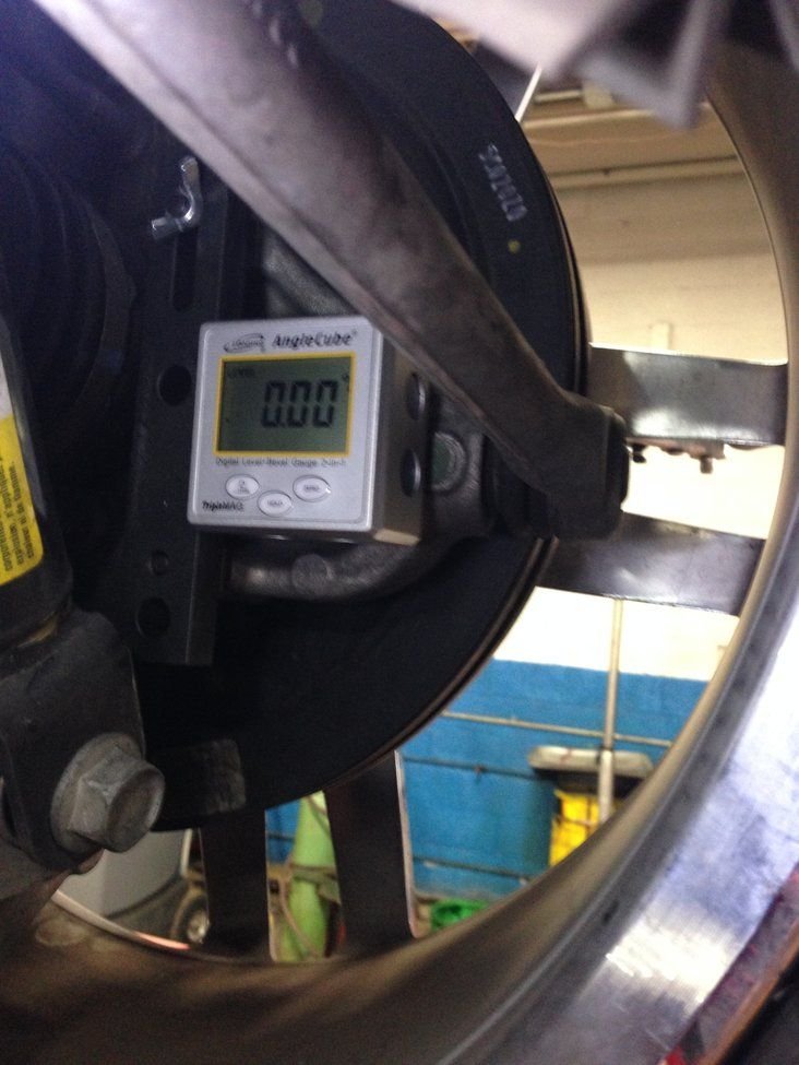

Alignment Machines Cannot Measure or Display Rear Caster. That is why this Tool is needed.
