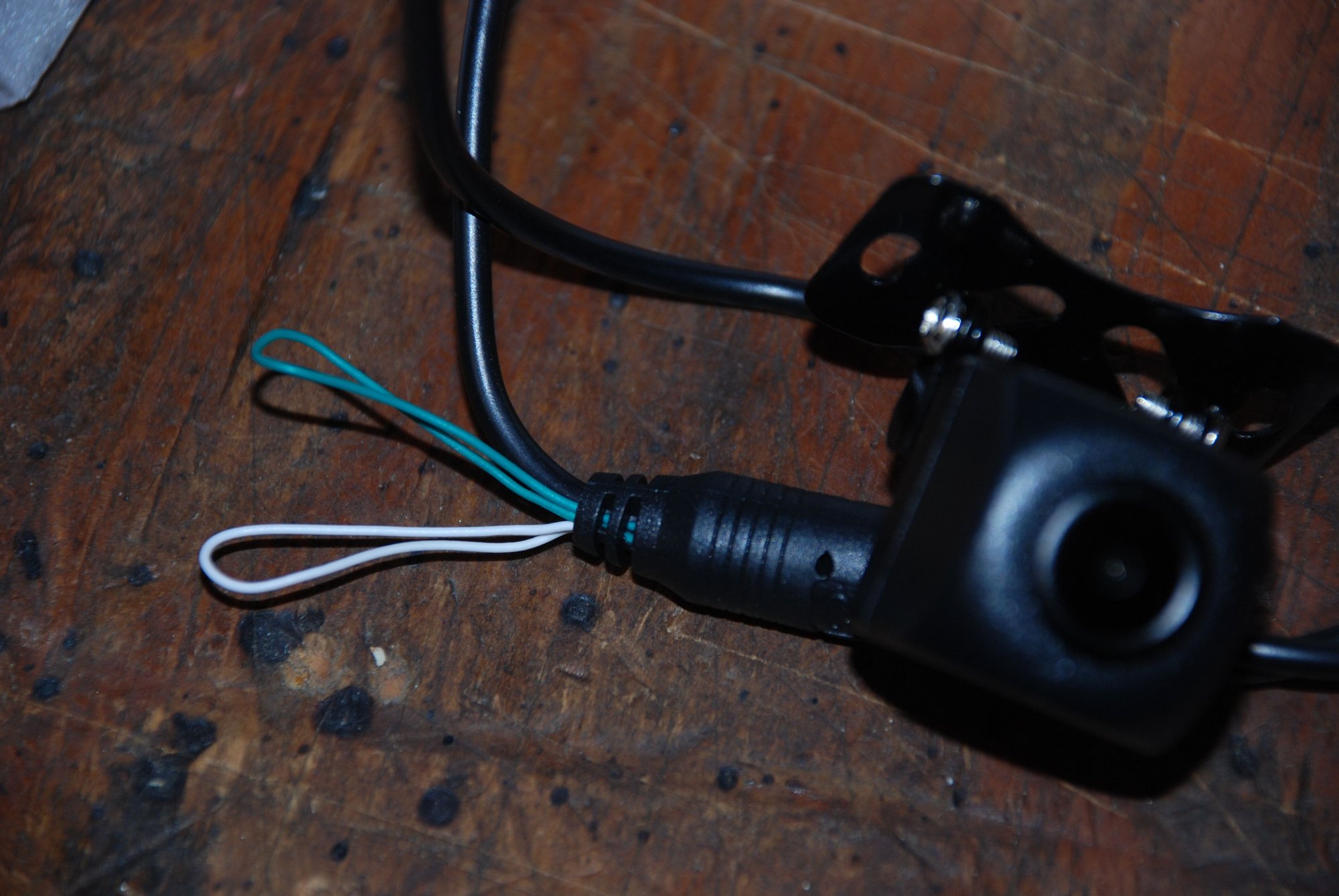

can you post a pic of there loops? im having issues with my front cameras as well

Here's the new camera's loops. Note: My front camera is aftermarket. THe OEM cameras do not have loops to cut. My camera is used with the Navtool aftermarket kit that allows streaming my iPhone to my Nav screen and displaying the front camera view on my Nav screen so I don't dork up my front splitter on a curb.
