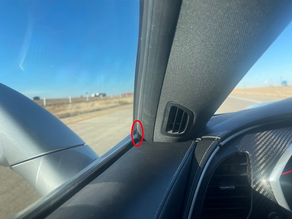

Wondering if anyone else has a very small gap where the drivers front window meets the rubber strip or if anyone has pic of this area with the window down or door open to see what's off for my car.
FWIW, I have a 2017 C7Z
No rain or anything comes in the gap, but I do get some wind noise, and I'm just trying to figure out if something is misfit, or how to best fix this.

Can you provide a better picture? Maybe a close up?

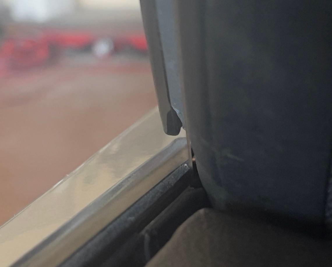

Here's a close up. In looking it appears my window striping may end a little soon. Is this correct? The gap is pretty visible.
I've indexed the windows and ran the top up and down a few times. It's been there the whole time I've had the car.

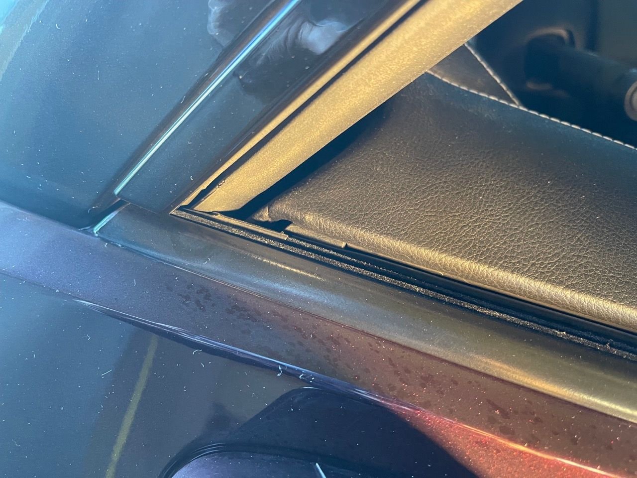

Here are two close-ups of the same area on my 2017. It looks to me as if your weatherstripping has been damaged.

Thanks orwollma
the comparison helps.

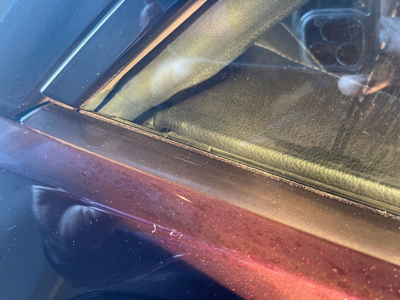

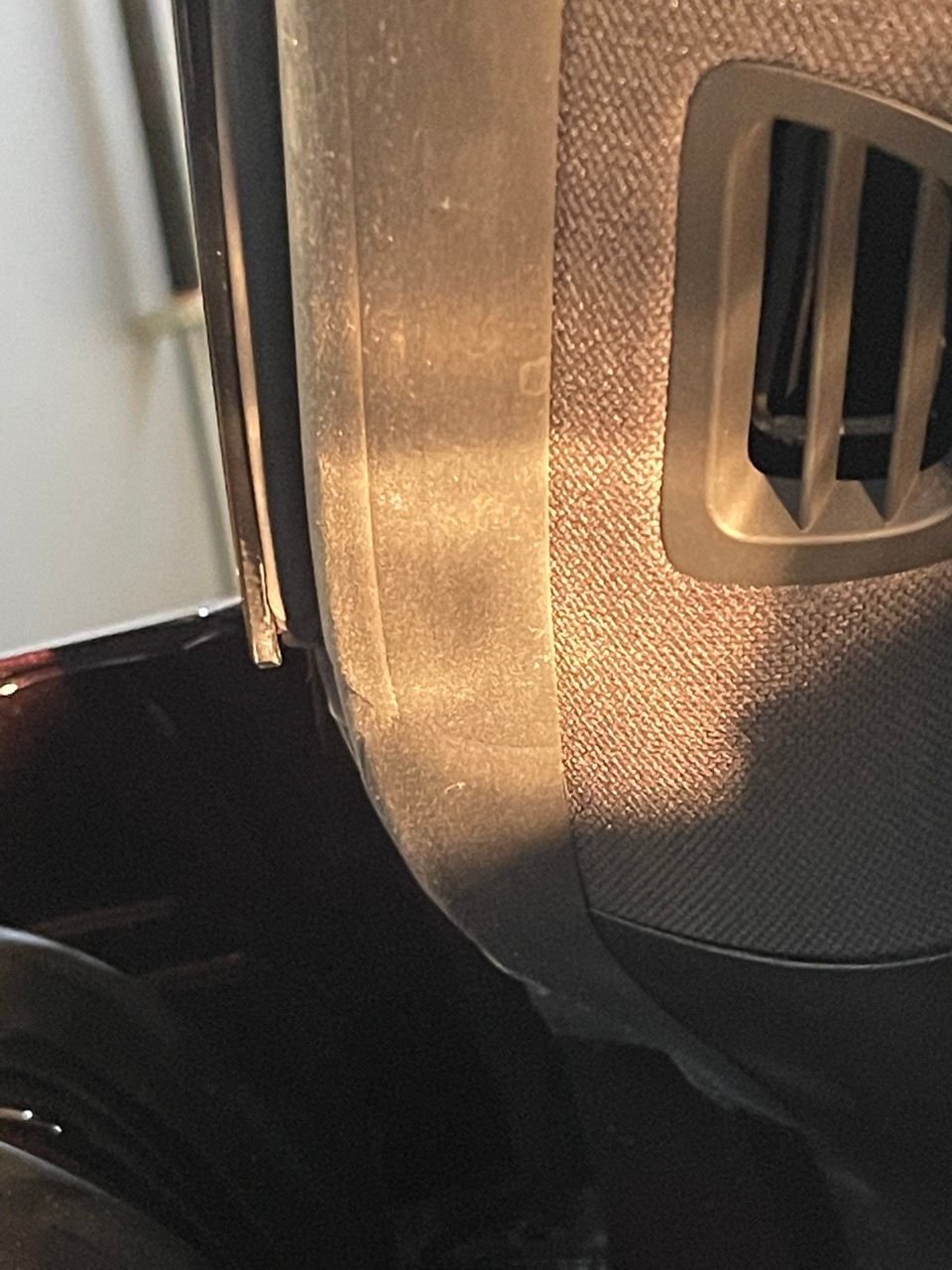

Here are two more pics from the outside: window up & window down
Window up; dirty car in the wintertime!
Window down.
