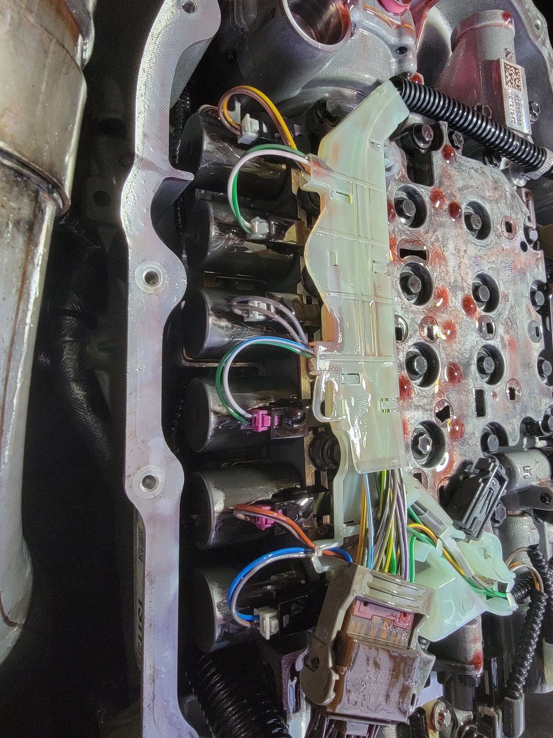

Can anyone provide the schematics or a picture of the location of where the Transmission temperature sensor is located? I know ithe transmission fluid pan must be removed and apparently it is located somewhere in there. This would be for the 2016 C7 Stingray Automatic Corvette.
Inside this harness ...

Can you point to it with an arrow? my mechanic couldn't locate it after he took the transmission fluid pan off.
There is nothing to circle, the reason why you are popping the code is because the lower wiring harness has a short in it, replace the harness and button it back up, you will be fine
Just click on my link I posted above, and it will tell you everything you need to know plus the part number. I even posted a video in the link ( its not me but )
Follow my directions closely as the new harness has different color codes that the original
GM replaces both the upper and the lower harness, but the upper harness requires removal of the valve body. I can tell you with a 96% certainty that the short is in your lower harness.
Dave

Dave, just to be clear my engine light came on and then I got a code but mine said Transmission temperature sensor. So I went and ordered the sensor. My mechanic (who doesn't specialize in corvettes) figured it would be an easy fix if it's just a sensor. We couldn't find any information on the internet to provide the location of the transmission temperature sensor.
Based on your experience you believe it to be a short in the harness and not the sensor, is this correct? Lastly, do you know where the transmission temperature sensor is located?
Thanks
Duvall I don't know what sensor you bought as there are many
if u popped a P700 and a secondary P711 CODE temp sensor out of range then u don't need a sensor, u need a harness ....
GM has a TSB for this problem as we are not the only people that have this problem as it is pretty widespread
Dave
