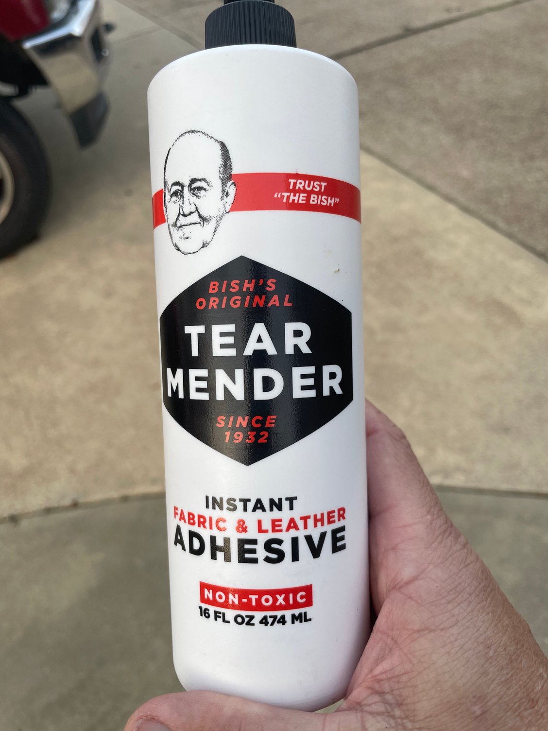

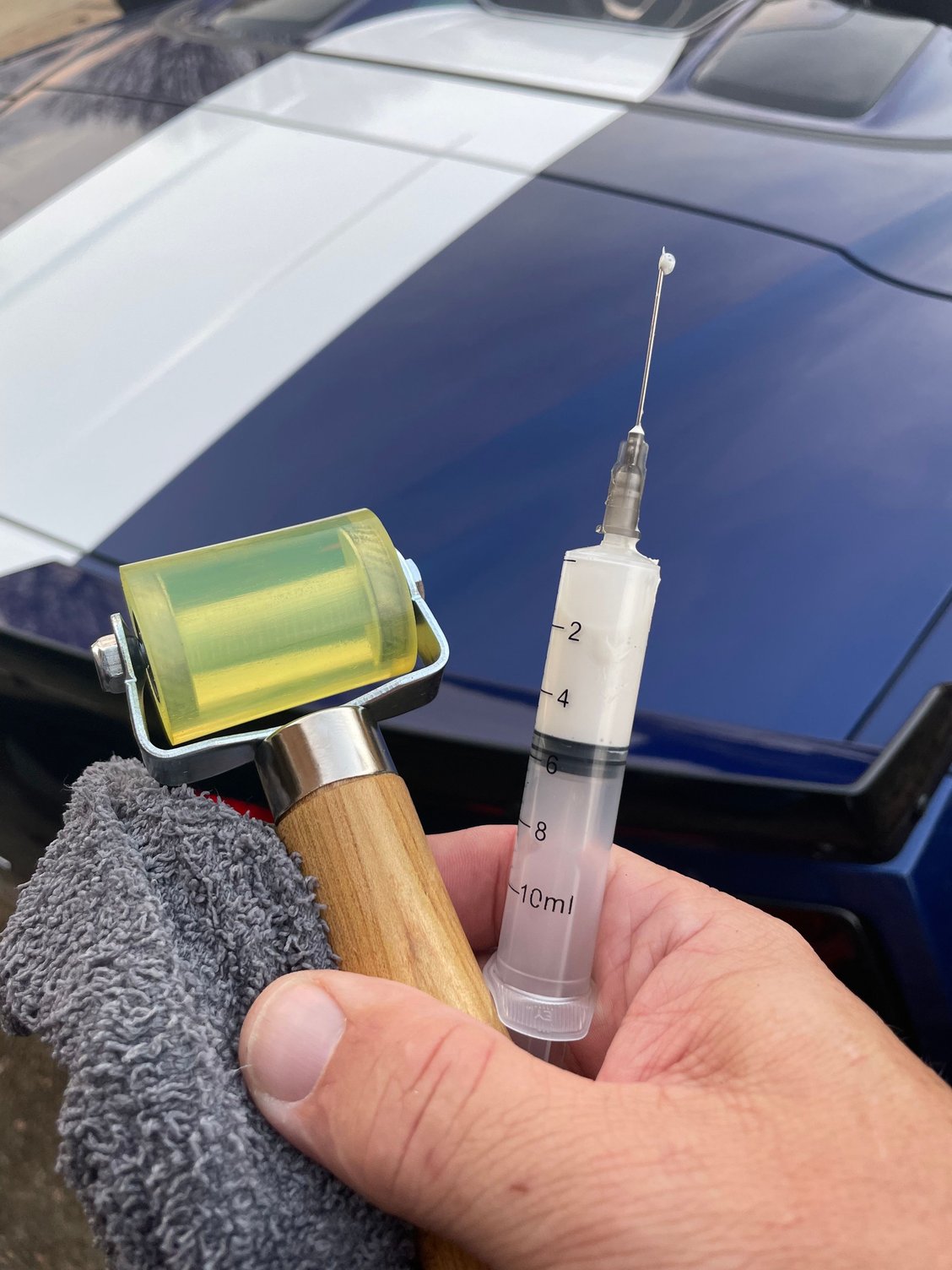

Well I repaired my dash with this method. My dash had about 40% disbonded and I would hear it up and only got a week or two before it would come disbonded again. It has been about a month and still no issues. I just injected fabric glue and used a roller to spread it under the dash. Very happy with the results and it was $25. Was told you would end up seeing the glue when it dryed but because there is a thin amount of foam under the leather you cannot. Will leave very small pin holes but hard to see. Also I put the needle in then pulled it back to be on top of the foam before injecting the glue. Worked great

Info on the roller and syringe/needle you used. TIA

all from Amazon. Roller is just a 2” and needle is 22ga 10 Cc

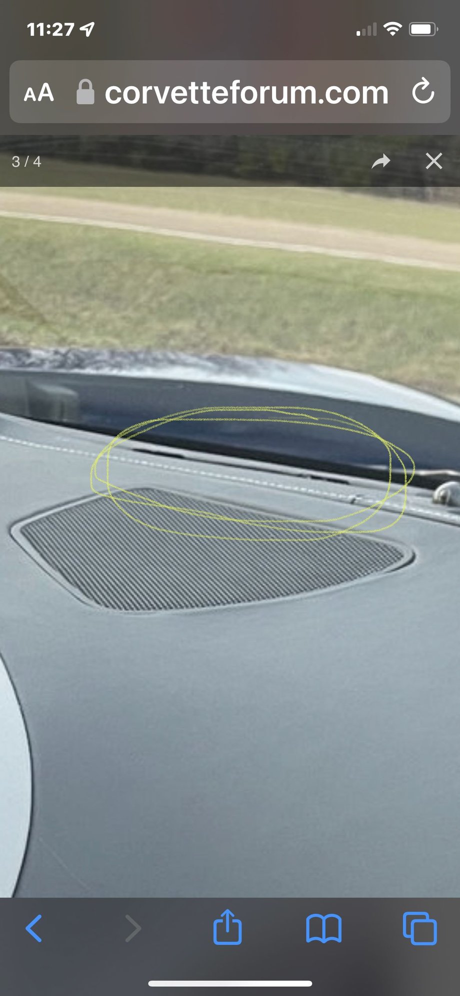

That’s awesome! I did a similar “fix” on this area I’ve circled on yours. It lasted for about a year before it started to shrink more. I am patiently waiting for a replacement dashboard that is on national backorder.
