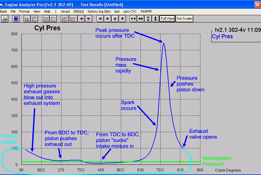

I don't expect you guys to have the PhD in mechancal engineering or the 25 years experience necessary to get these details. I am giving you heuristics and you can take this opportunity to increase your knowledge fundamentals. I've helped build and tune hundreds of vehicle which utilize stock engines that will outlast the original configurations because the most wear is caused by overlooked items as air filtration and PCV component features, which I developed a strict guidelines to overcompensate above and beyond OEM so the engine despite producing 2x to 3x original output will last longer than the original versions.
here is a visualconcept for what I described using words that you pretend makes no sense. Yet here it is in perfect sense.
The peak cylinder pressure is the peak stress to the piston lattice crystal. I don't have time to discuss application for 3D stress tensor in lattice formation but suffice to say the original engineers are well aware of directional forces associated with stress within the lattice and since 1988 for Toyota/Nissan and since 2001 for Chevolet all brittle fracture failure pistons (original style pistons with tight piston-wall) produced affect the modern production for directional lattice atomic structure resilience to applied stress. The similar technology in maingirdle and pan support derived from 3D computer modelling of stress in block design was necessary to bring the entire engine configuration safety factor approximately equal. In other words, the block, crankshaft, rods, pistons etc... are all engineered to fail around roughly the same internal parts stress ratios to one another. As evinced by the way we use these modern, original engines in racing applications,
A stock bottom end Gen4 engine 05-07 will do 1000rwhp reliably for 200,000 miles
https://www.theturboforums.com/threa...2#post-2042556
So unless you want a 1200+hp setup, I stick with the factory parts. Guys are revving these things to 8400rpm and making 1400hp for multiple seasons when tuned correctly. Thats pretty impressive for a $300-500 long block IMO.
now lets briefly discuss piston stress and parts stress in terms of the picture I posted.
The connecting rod forms an angle with the crankshaft and from this is derived the vector force cross product applied to the crankshaft as a result of pressure over area applied to the piston in the Y-axis. That is, useful force applied to the crankshaft is only available during specific crankshaft angles. In particular, a piston at Top Dead Center, provides ZERO net force in a useful direction to the crankshaft. Now look at that picture of cylinder pressure- how much pressure is applied at TDC to the crankshaft? Quite a lot of pressure (STRESS) is applied at TDC yet none of it is doing useful work.
This example illustrates the simple fact that a massive stress may be applied to the engine internal components with absolutely no work being done to the crankshaft or tire. We can easily take a factory engine and rapidly advance the spark timing beyond safe limits and shatter a piston due to pressure/stress forces while actually reducing the engine power significantly. This again is showing us that, stress has little to do with power. Stress is not a component or feature of power production. We can over stress an engine without making any power at all. Once you understand this basic tenant and remove any connection in your mind of power with stress, you will begin to see why we can produce 2x or 3x the power of the factory engine without producing any significant extra stress to the engine internal components. Particularly look at the pressure in the cylinder after TDC- it begins to drop rapidly. Increasing the volume of the cylinder as piston descends and rapidly diminishing fuel molecules with oxygen to interact with results with a drop in pressure. In Forced induction applications, we can significantly increase the area under the curve of the post TDC pressure applied force to the crankshaft without increasing the peak. In other words, we can produce far more power than a factory engine without actually adding any stress to the piston or internal components whatsoever- because stress is unrelated to power. Stress is related to the pressure/area or force applied to the pistons so by virtue of extending the pressure without increasing the peak the force is applied for longer duration without increasing it's magnitude resulting with more power to the tires and no additional internal engine stress.

I do not have a PhD in mechanical engineering but I do have a bachelors in mechanical engineering and 20 years experience in manufacturing.
Sorry bro, but going on about lattice structures is pretty lame and it's obvious you are trying to sound smart and throw out engineering terms thinking I don't fully understand all the fundamentals of what you are saying.
I know enough to know when a guy is just is trying to overcompensate.
Not even going to bother going through your wall of text line by line to correct your out of context asssertions because I don't care enough
Just saying though, you are the guy who initially made reference to a STATIC structure with a STATIC load applied to it and used that in the context of stresses on a reciprocating assembly with hundreds and hundreds of moving parts

There is no such thing as a static structure. At all temperatures above absolute zero, everything is in motion.
If you disagree with real world results
That is your blind eye. The engine in my vehicle came factory 280bhp now has over 700bhp and it is the same reliability approaching 300,000 miles in the next 5 years. You are missing the data and evidence, ignore it, but it remains. Forced induction in and of itself does not reduce reliability. Properly setup, a turbo can increase reliability and power.
