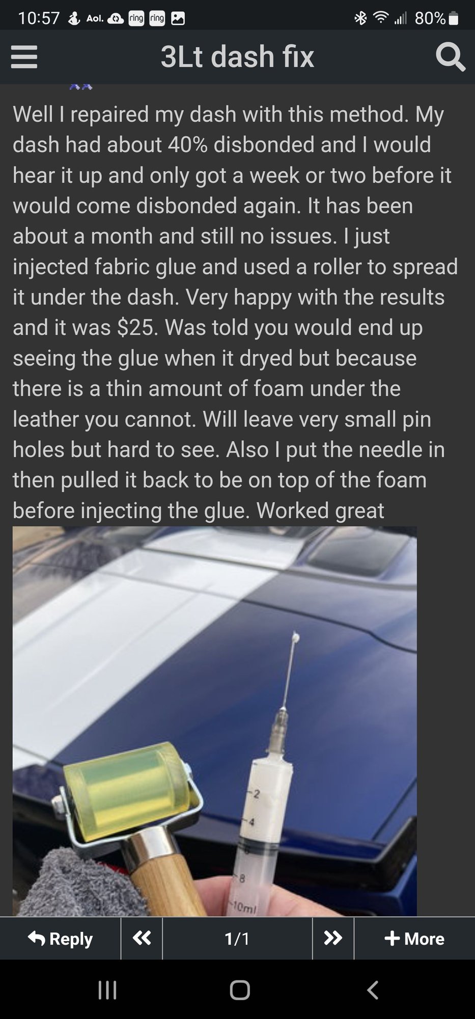

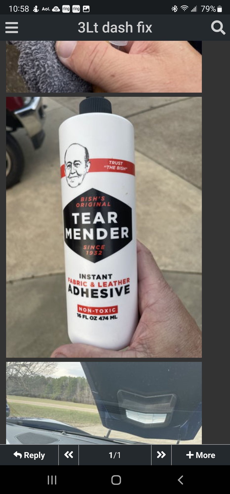

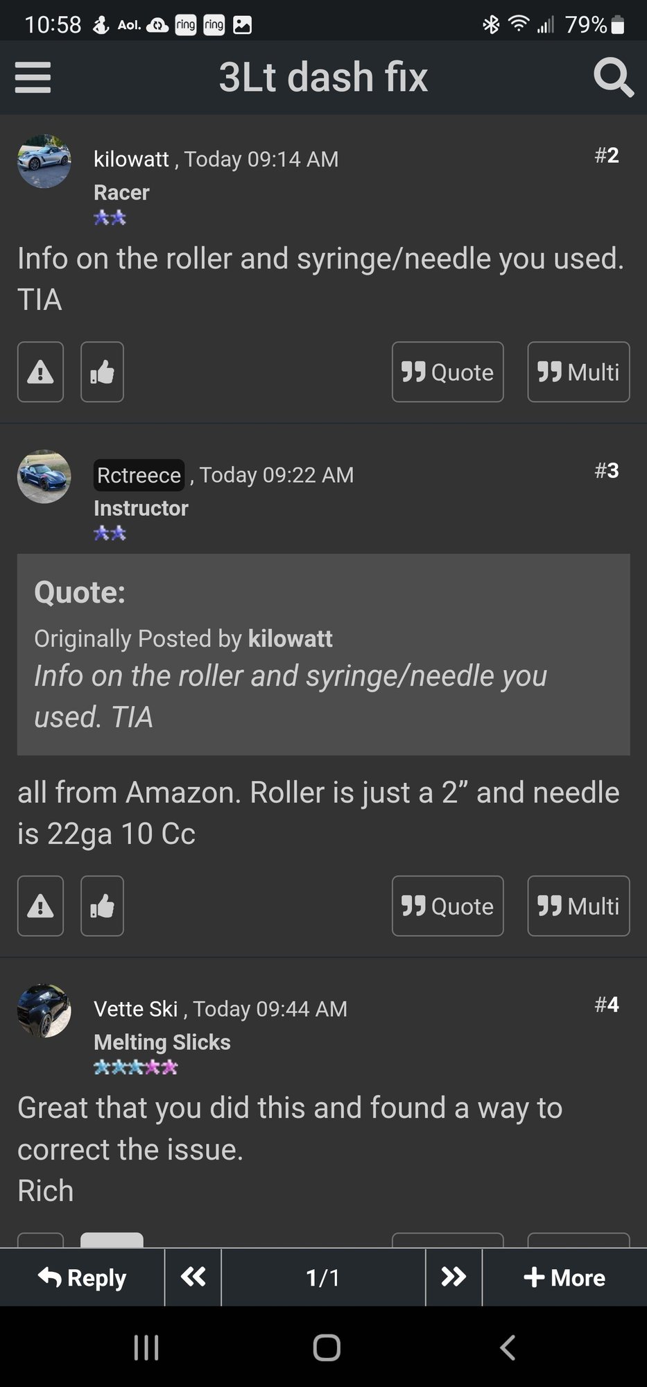

Somebody on this forum just posted about this and his solution. Seemed to work perfectly. He used a syringe, glue and a roller. I screen shot his post. I'll share it here.
