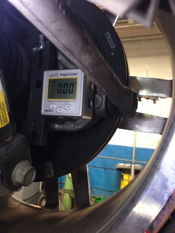

Did the Shop have a Rear Caster tool ? If Rear Camber was Adjusted it will Change Rear Caster. They have to be Adjusted Together. Alignment Machines Can Not Measure or Display Rear Caster

I just had the front done. My rear tires are wearing just fine. It sure does drive a lot better!
I am aware of the rear camber/caster settings.
