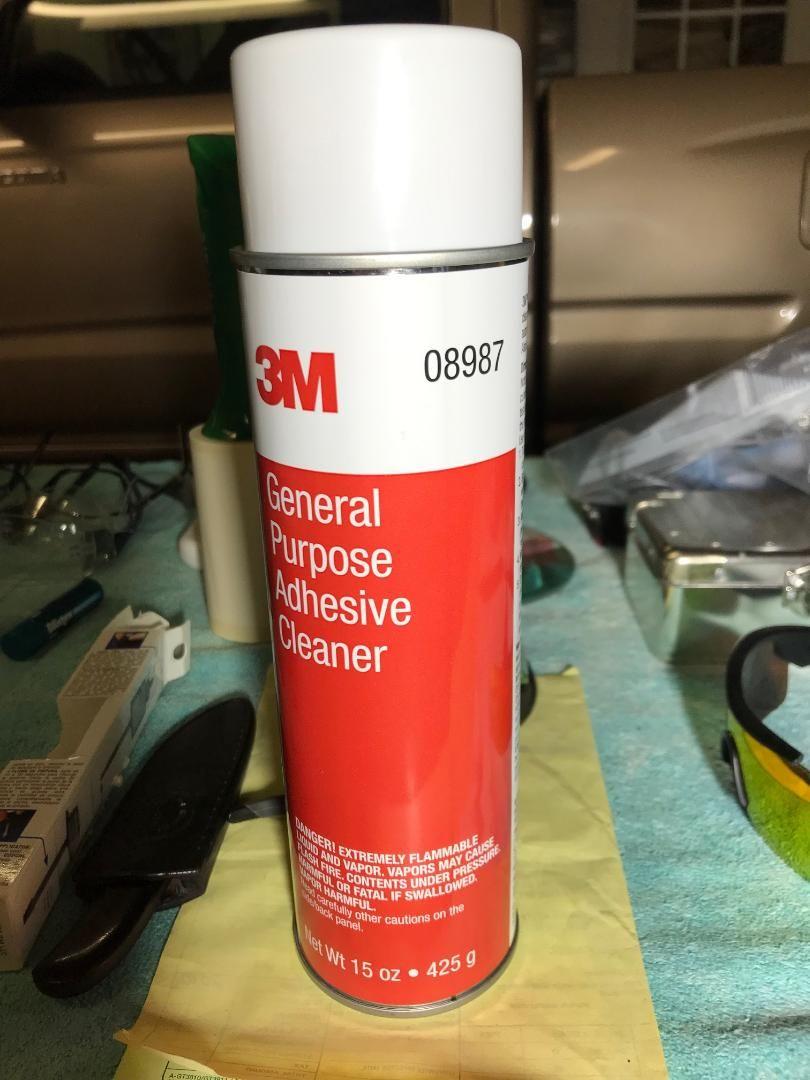

Above advice is spot on, especially referencing existing locations with painter's tape. That's worked great for me with similar projects. Also, I'd use 3mm General Purpose Adhesive Cleaner remover for clearing as opposed to Goo-gone and alcohol.
When ordering new, keep in mind that the front emblem and rear are slightly different size. Good luck!
