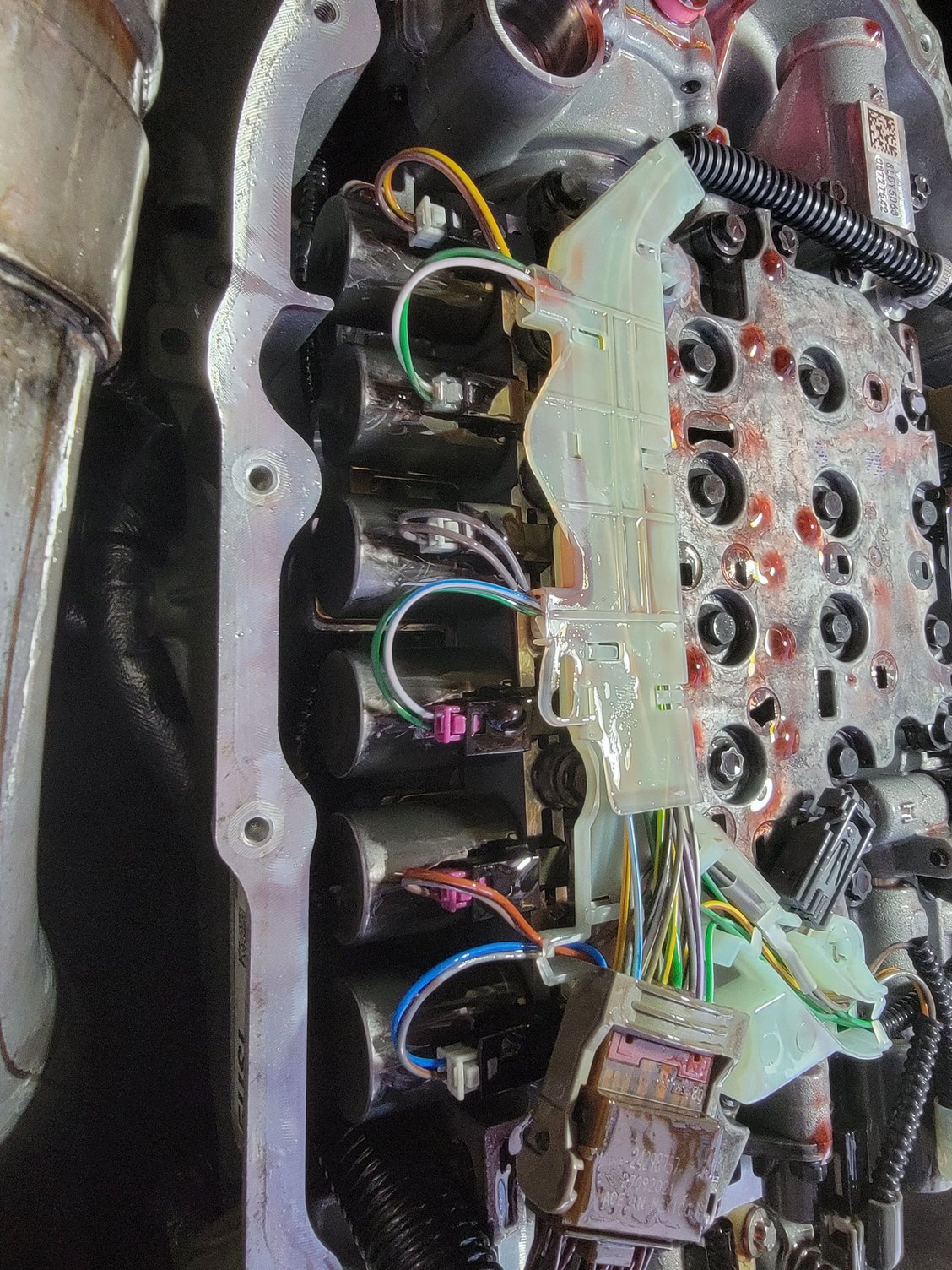

if i had to guess, it's a p0711 code , which is a short in the trans harness temp sended harnesses , there is aTSB . If your trans temp guage is barely going above then the harnesses are your problem

Yep had to change mine out , TSB says to change out both harnesses out but the upper required removing the valve body and a bunch of other things . I just replaced the lower which contains the temp sensor. Dealer wanted over $700 to replace . I ended up doing it myself in 2 hours with just the cost of the harness , transfluid and filter Dave
