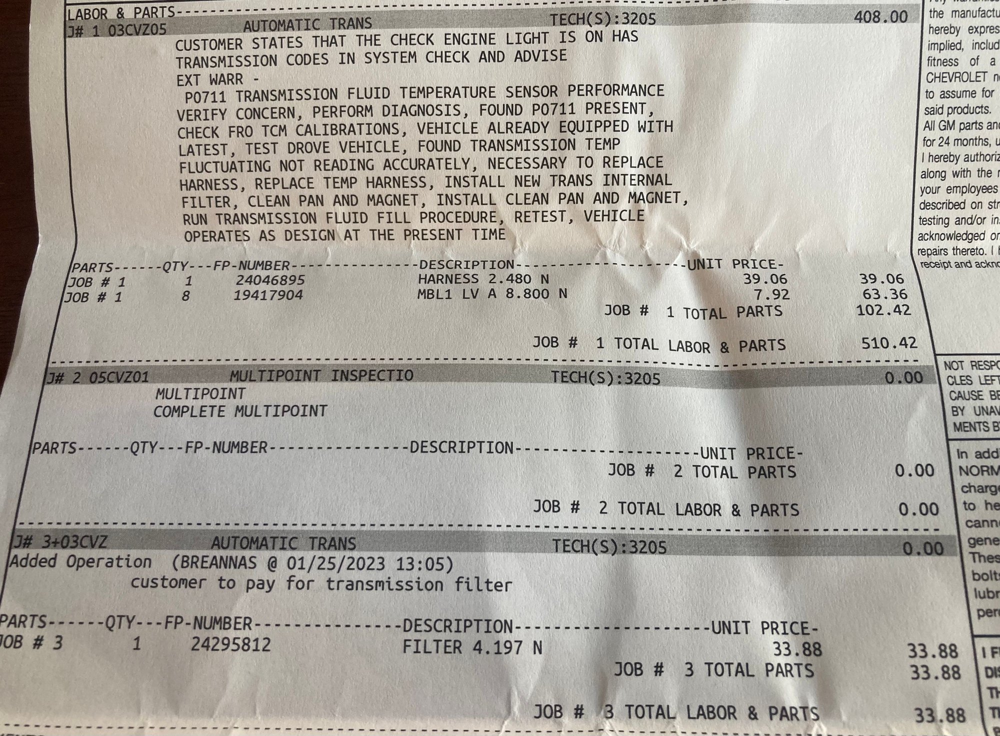

Picked up car at 3pm. Made it home with no problems. 😁. Dealer billed GMEPP $518.87, I paid $36.67 for the filter. Hopefully done with this. I do plan on getting a scanner just to carry in the car.
