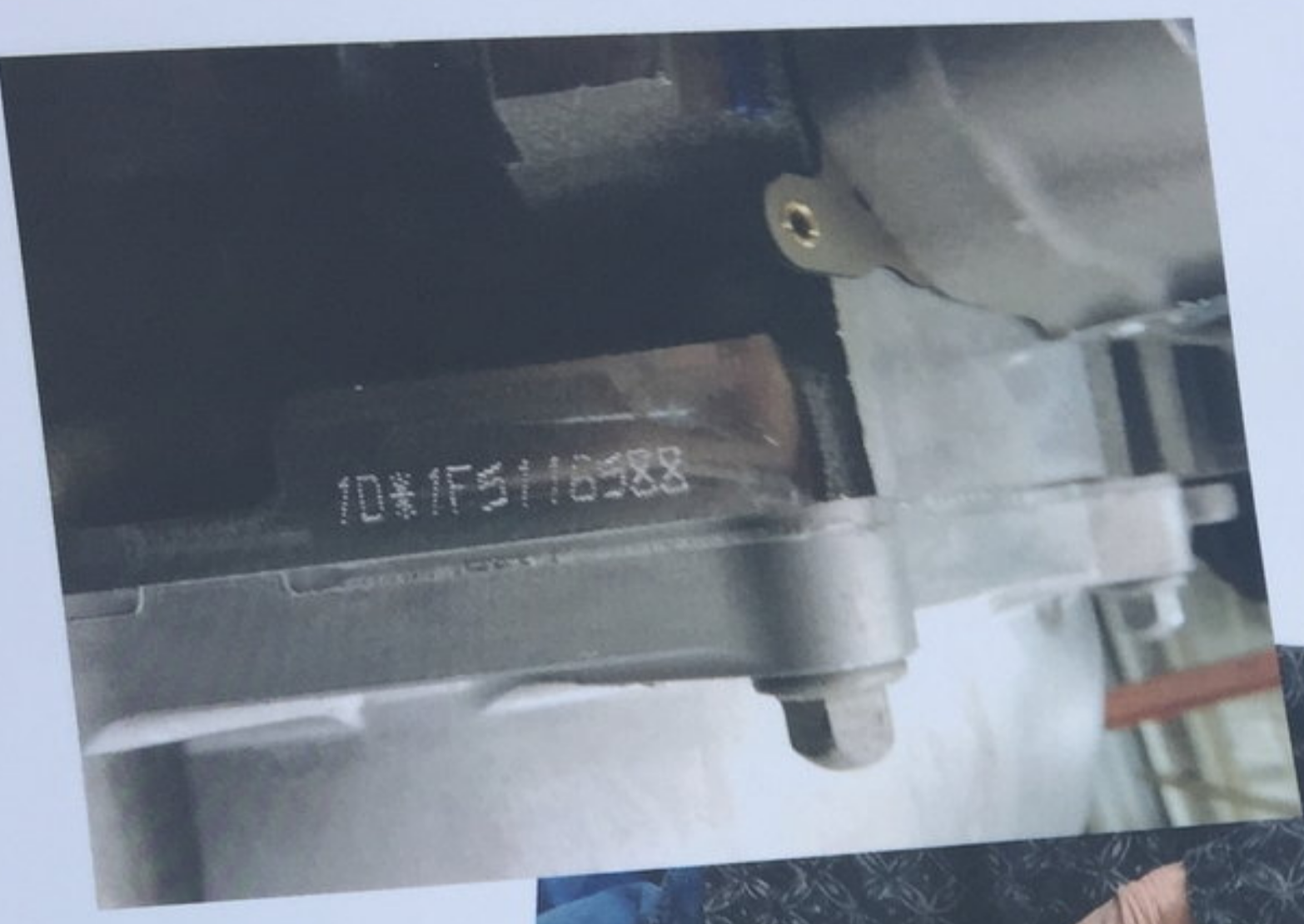

I am shipping one of my Corvettes (C7) to the UK. They require the engine number of the vehicle. What a pain trying to find it! Does anybody know if it is on the build sheet of the car??

Check here: Left side rear of the engine block. It's eleven digits on two adjacent pads. I copied this from another post on the forum.

Unless the engine has been replaced it will be a derivative of the VIN.
Old Feb 7, 2023 | 10:31 PM
RMS73's Avatar
RMS73
Joined: Sep 2000
Posts: 2,409
Likes: 420
From: Chester Virginia
For 1F5118588
1st Number = GM Division: 1 Chevrolet
2nd Number = Production year: F = 2015
3rd Letter = The assembly plant: 5 = Bowling Green
Last 6 Digits = Equal the last six digits of the vehicle’s VIN: 18588 = Car Sequence Number

The year and plant characters are handled the same way as they are in the VIN. E = 2014. F = 2015. K = 2019. 5 is the plant code for Bowling Green.
Engine example: 1F5118588
VIN example: 1G1YK2D72F5118588

Corrections:
For Engine ID 1F5118588
1st Character = GM Division: 1 Chevrolet
2nd Character = Production year: F = 2015 As in the Engine ID on my 2016 Vette: G=2016 and in my Vette VIN there is a G in the year place holder
3rd Character = The assembly plant: 5 = Bowling Green
Last 6 Characters = Equal the last six digits of the vehicle’s VIN: 118588 = Car Sequence Number
