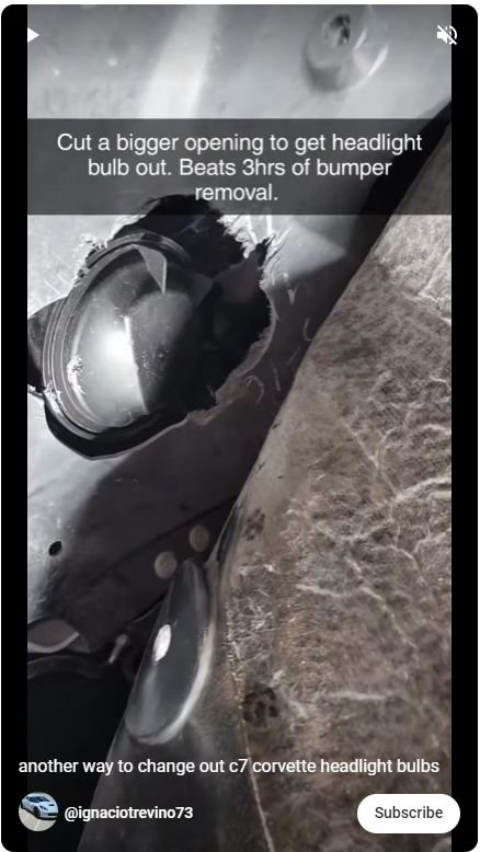

Yep, after following the link sjw91 points to, I agree, it appears changing the bulb from the inner fender may be more difficult than first thought. But I'm still not sure whether I would enlarge the hole or just pull the bumper. I really don't like cutting into the liner to save time, but GM could have been more thoughtful by enlarging the hole.
As others have suggested, I believe it is best to change both lamps at the same time.
Below is a screen shot from a very short youtube video
posted by Dif https://www.corvetteforum.com/forums...amp-yet-2.html #21 of the inner fender and liner. Looks like the owner/whomever had to open the hole quite a bit to gain full access.

Would not want to 'hack' up my car by making a big ugly hole.
Sawsall anyone?

SO get the wheel and fender liner out of the way and then cut a hole in some plastic liner to get at the bulb? Sorry, that does not appeal to me as a good thing to do. I wonder what that liner is for? Water hitting the light pod? Some aerodynamic seal for the air flow in the engine bay?
Looks like I'll be taking the nose off if another bulb goes bad.
Elmer

Im still going to remove the bumper cover. I would never hack a big hole in my Corvette.
