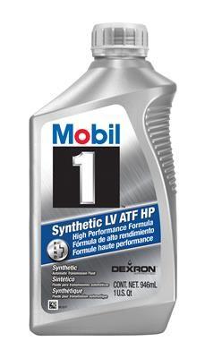

Originally Posted by chuckrbt
My thanks to all for your responses. My car was a 8/18 build, so I will follow up with customer service to see what can be done.
Perfect. So assuming you have less than 60k miles and your powertrain warranty is still intact, this will be a 0 cost event for you. This is the correct fluid per the GM TSB
