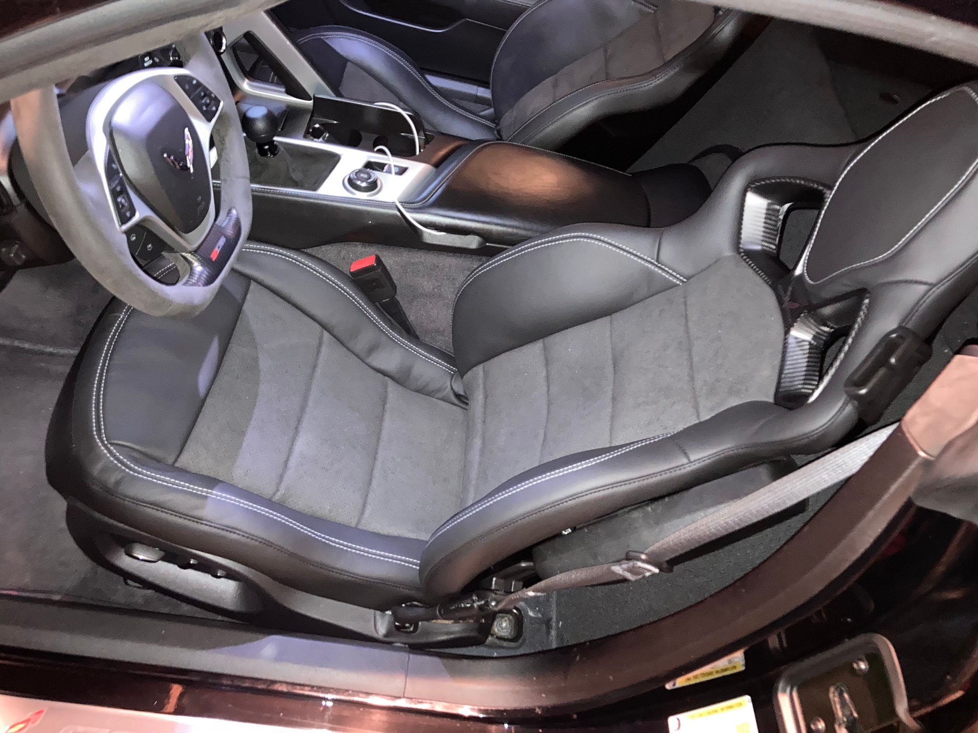

I bought a used 2015 ZO6 3LZ. 10606 miles. The drivers seat bolsters closest to the door are worn. I don’t like it. I have ordered replacement covers for the seat that match interior. Has anyone replaced their seat covers. I’m looking for any helpful hints or anything to look out for. Thx

Search for C7 Competition Seat install on this forum and on Youtube. It is actually quite easy to swap out the seat covers. Basically disconnect the battery, unbolt/remove the seats and pull out the seat cover edges from the plastic C-channel wedge on the seatback shell.

Here you go. Many of us have converted to comp seats over the years. This will give you step by step instructions on how to take off your skin and replace it. Unless you go all out and move to converting to comp seats…. Lol

Yup, it's much easier than you might think. Have a flat plastic pry tool handy. As mentioned, great how-to in the conversion thread

I finished putting on the replacement seat covers. It didn’t go too bad and I’m happy with the results. That center piece under the head rest was difficult for me to get back in and as perfect as I would have liked and a wrinkle in the rt side seat bolster. I’m glad I didn’t need to replace on the passenger side!

yup it can certainly be challenging getting all thise clasps in at one. Good job
