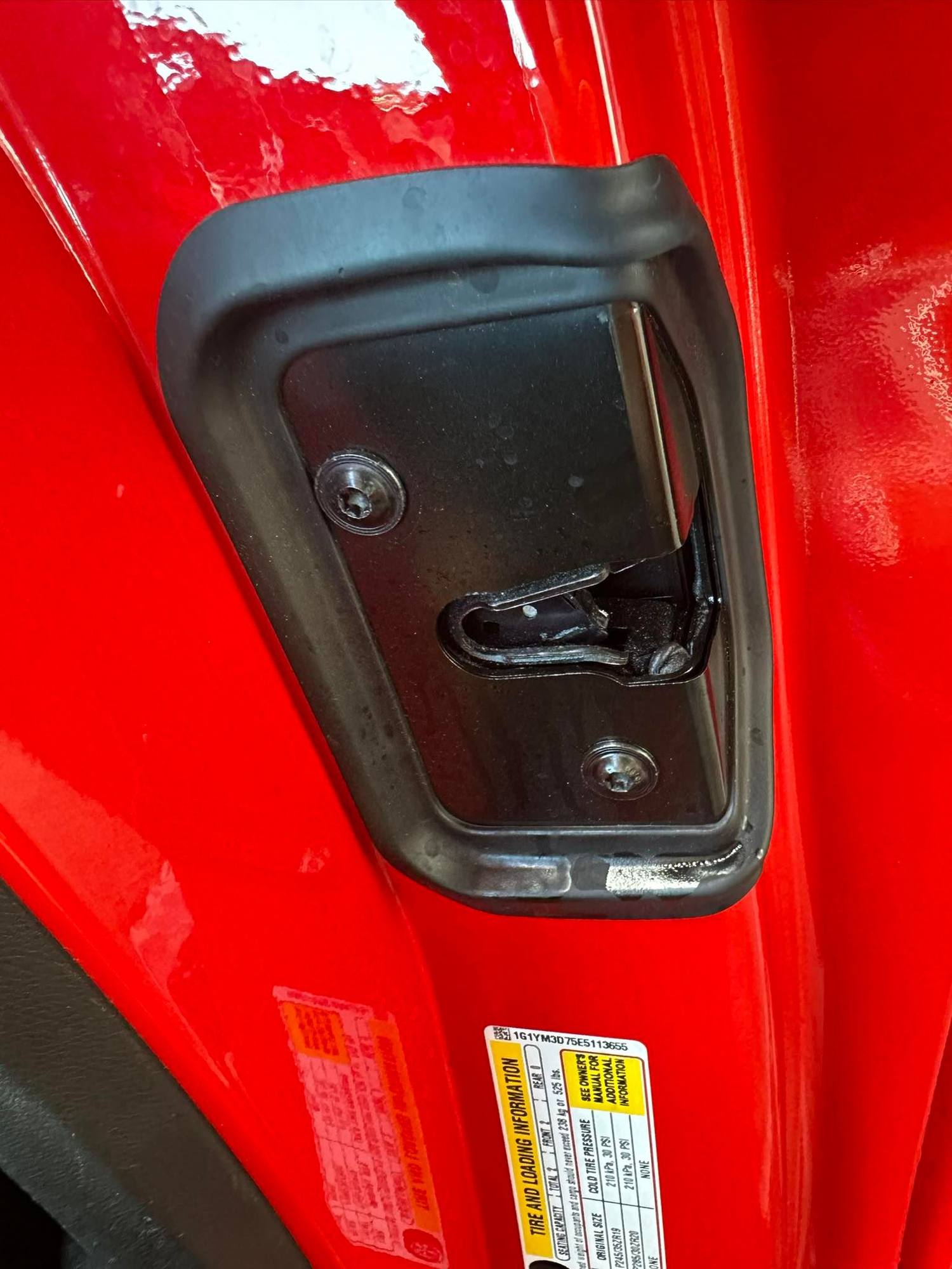

Default Parts number and photo
Originally Posted by Sixgun95
UPDATE: Finally found a great Indy who quickly diagnosed and fixed the problem. It was the door latch mechanism (on the body, not door), replaced it and good to go!!! There were zero in stock anywhere, so the Indy found one on eBay, thought I was going to have to trade it in on a C8
Hello Sixgun95,
Please can you provide the part number and photo.
I have the same problem but I leave in Tahiti French Polynesia we don't have any Corvette parts dealer or certified mechanic.
So the shipping or parts is very expensive and I don't want to order the wrong part..
Is that the part on the photo ?
Thank you.

Here you go https://www.gmpartsdirect.com/oem-pa...latch-84451453
That is the part in your picture. We could not find any in the USA at a parts store or at GM, had to revert to eBay.
Hope this helps, good luck.
