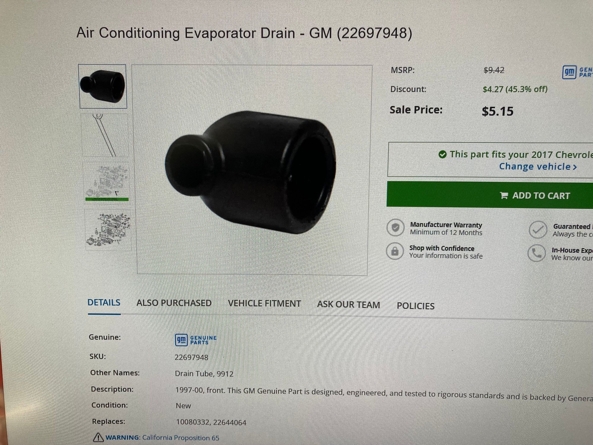

Yes, I have heard of the "Afterblow" feature. Why do you think GM has this feature in the software but doesn't enable it from the factory? Also, I found my drain tube (there is no actual tube just this molded part) and it doesn't look clogged as it was wet around the opening. Here is what it looks like:

Thanks for the parts picture!
My guess:
Afterblow is not factory-enabled because not needed in some areas; puts an additional load on the battery, and would confuse owners who wonder why that fan starts running long after the engine shut down.
