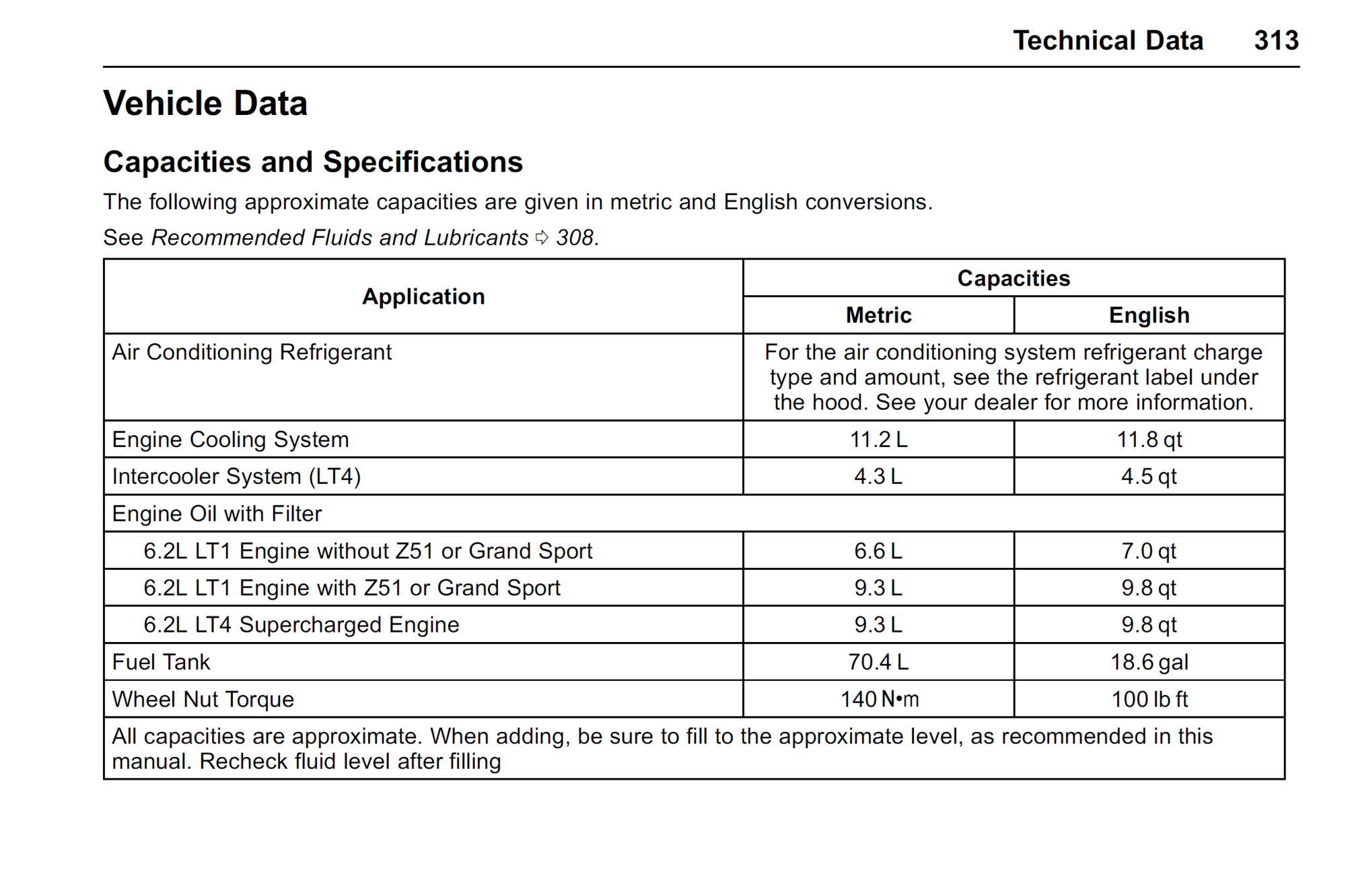

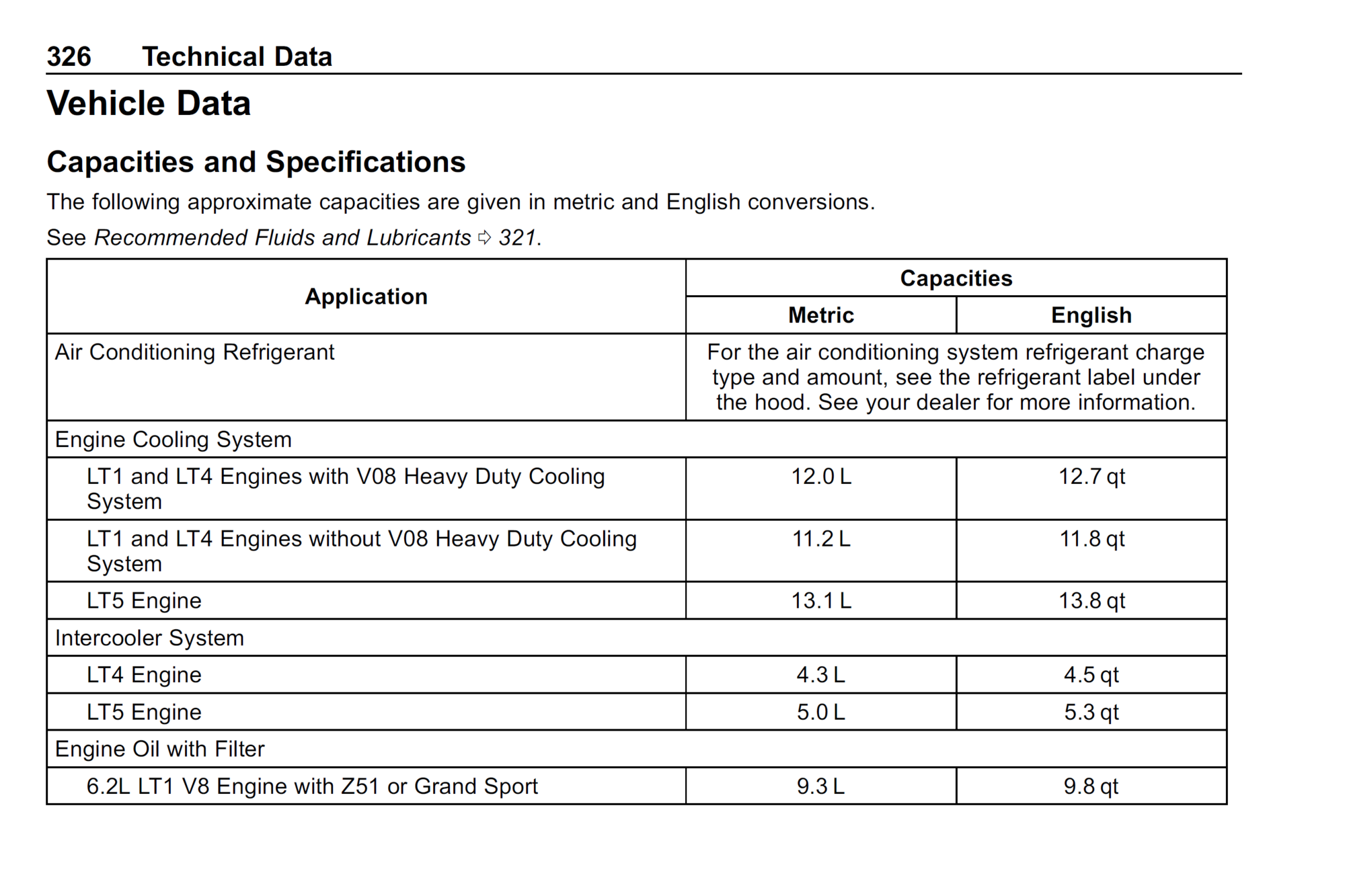

The Corvette uses a 40/60 Dexcool/Water mixture. The cooling system capacity can be found at the rear of your OM. Here is the latest info from the 2019 OM:
LT1 engine is used in Stingray, Stingray Z51 and GS. LT4 is only used in Z06 and the LT5 is only used in the ZR1.
Here is the same info from the 2018 OM:
If you have a 2019 you can check your RPO list to see if your car has RPO V08. The amount of Dexcool coolant you will need will be 40 percent of the quantities shown above. To get there you will have to drain and refill your cooling system with clean drinkable water several times (running the engine after each subsequent refill to get the thermostat open and move coolant out of the heater core) while watching for the drained fluid to run clear with no color at all. Once you have clear fluid coming out of the drain you will have all of the old Dexcool out of the system with only a couple of quarts of water remaining. Make sure the drain is closed and add the quantity of Dexcool needed to get to 40% (40% of 11.8 quarts is 4.72 quarts of Dexcool which is just a little over a gallon. I would add 4.75 quarts (easier to do) and then top off with clean drinking water until it reaches the base of the reservoir fill neck. Run the engine for two minutes between 2000 and 2500 rpm then allow the engine to idle for a while and top off with another quart of water if necessary. Install the pressure cap and let the engine cool and top off with water if necessary.

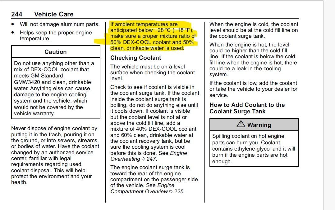

What happens if you slightly exceed the 40/60 mix?
I am looking to lower the freeze protection.
Old Oct 19, 2023 | 10:26 AM
sjw91's Avatar
sjw91
Joined: Aug 2005
Posts: 1,318
Likes: 818
From: Melbourne FL
Old Oct 19, 2023 | 12:01 PM
aklim's Avatar
aklim
Joined: Jul 2004
Posts: 28,462
Likes: 3,288
From: Hartford WI
What temperature are you looking for protection from?
To Draining the cooling system
Old Oct 19, 2023 | 12:19 PM
49FIS's Avatar
49FIS
Joined: Mar 2020
Posts: 215
Likes: 62
From: PA
Thanks for the replies.
Was thinking -20.
40/60 should be sufficient
