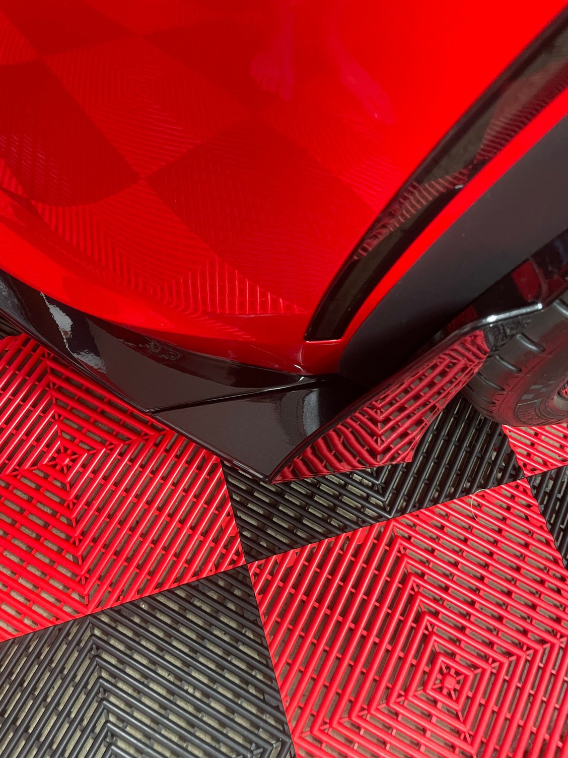

If they are 1 piece it is hard to tell by the pic it must be aftermarket. If not something changed in 2018 that I’m not aware of. Here’s a picture of mine with the stage 3 canards on and you could clearly see where the break is at the edge of the splitter

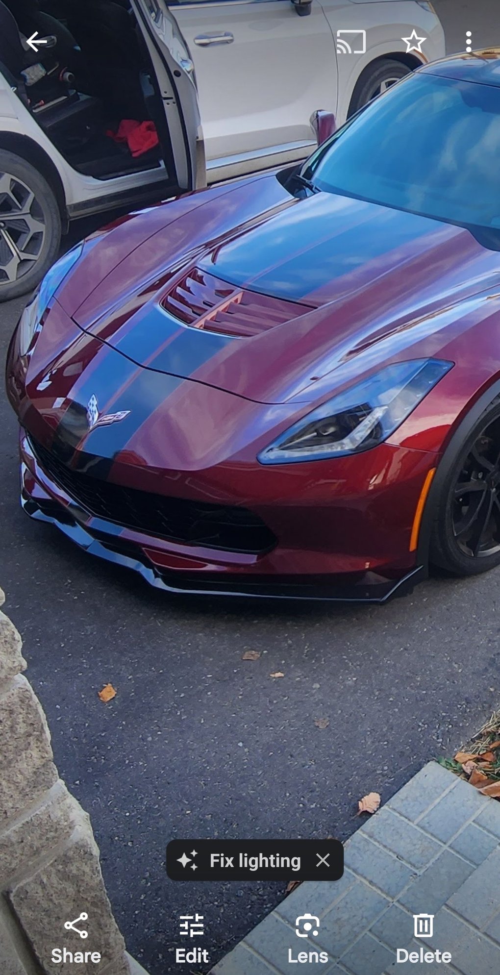

Originally Posted by Kent Rankin
I need some help here. I have a 2018 z06 with stage 2 front spoiler with the lil wiglet deflectors (factory) installed on my car.
Now I bought stage 3 winglets to install but every pic and video I have seen, they are installing them on a stage 2 spoiler without the lil factory winglets. What I'm asking is, am I pooched with the higher ones as I already have the lil one which is one full price on factory spoiler.
Hard to see but it's 1 full piece
See, it's all connected full carbon fiber spoiler. So guess I'm screwed with installing stage 3?

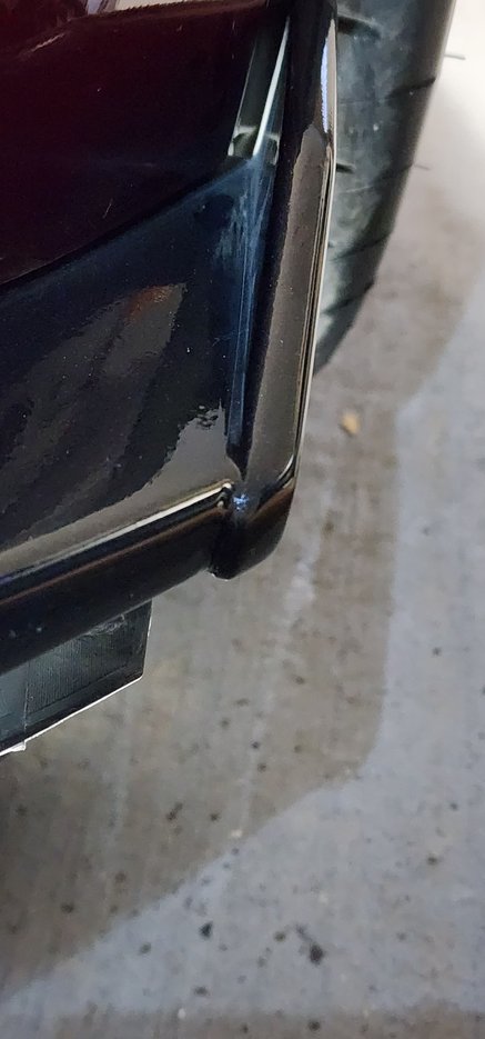

Just found out from dealer that it's a carbon flash package the previous owner purchased when built the car. So if wanted OEM, that front spoiler and stage 3 winglets would be $5k cdn.

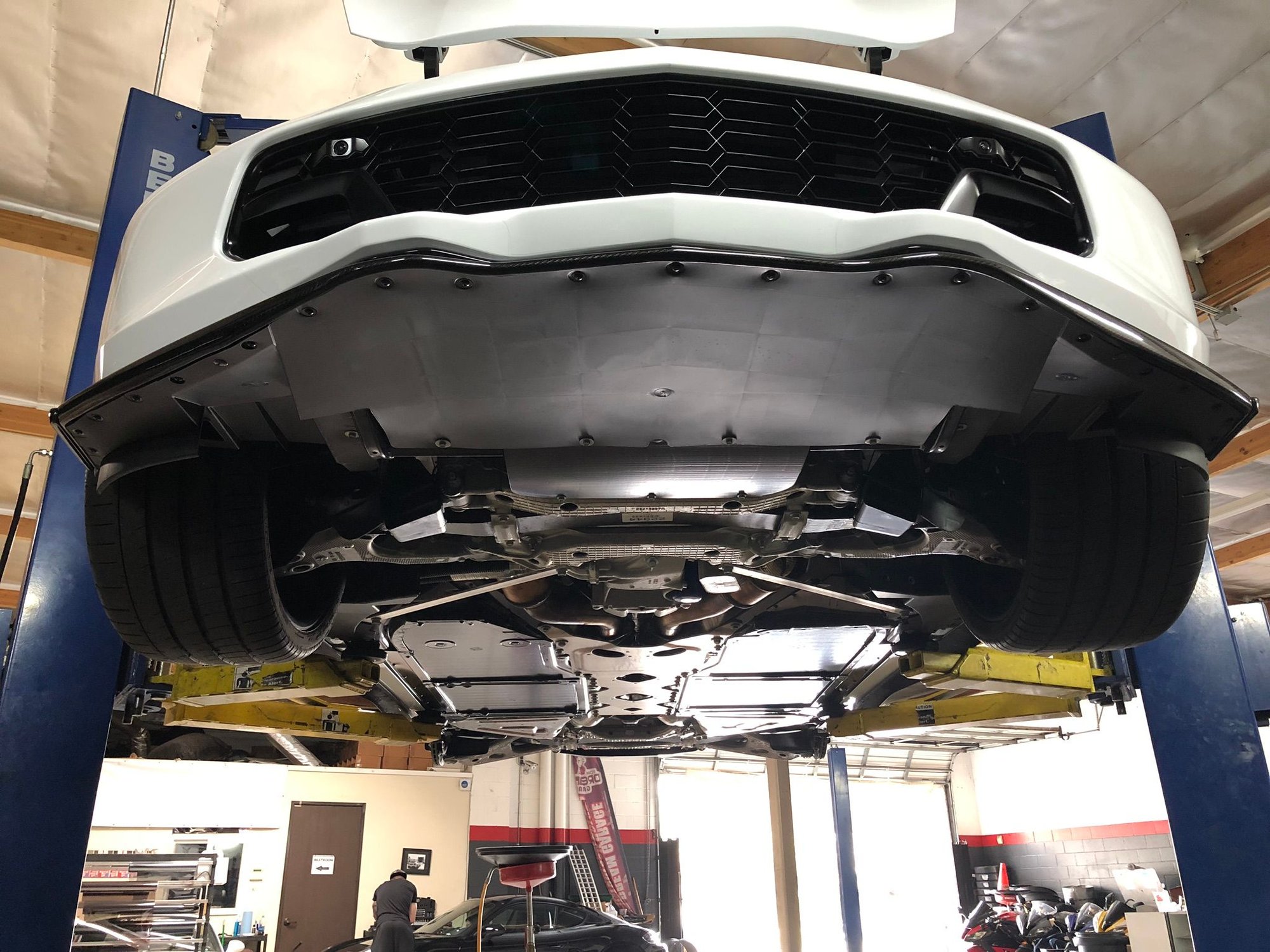

lol It's not a skid plate protector. It closes out the underside of the car to lesson lift and it has molded in brake cooling air channels. It attaches to the underside perimeter of the splitter and to the cross-member. Something like 30 screws hold it in place. You have to remove the screws from the ends so that you can access the nuts securing the splitter end plates.
Underside of mine....
