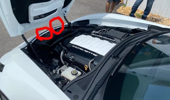

Hi, what length are these bolts? I tried to go off the bumper diagram on a gm site, but I think that's not the right size.
I know they are M6x1x (length?) torx screws

According to this site Bumper & Components - Front for 2016 Chevrolet Corvette | GM Parts Store , it is an M6x1x25 multipurpose bolt but the one I took out is a t30 torx screw that seems shorter than 25mm

Nevermind, I think I found them - GM Flange Pan Head Torx Bolts W/Locktite Pack of 5 New OEM M6 X 1 X 17 11570218
Hopefully someone in the future will make use of this <3
