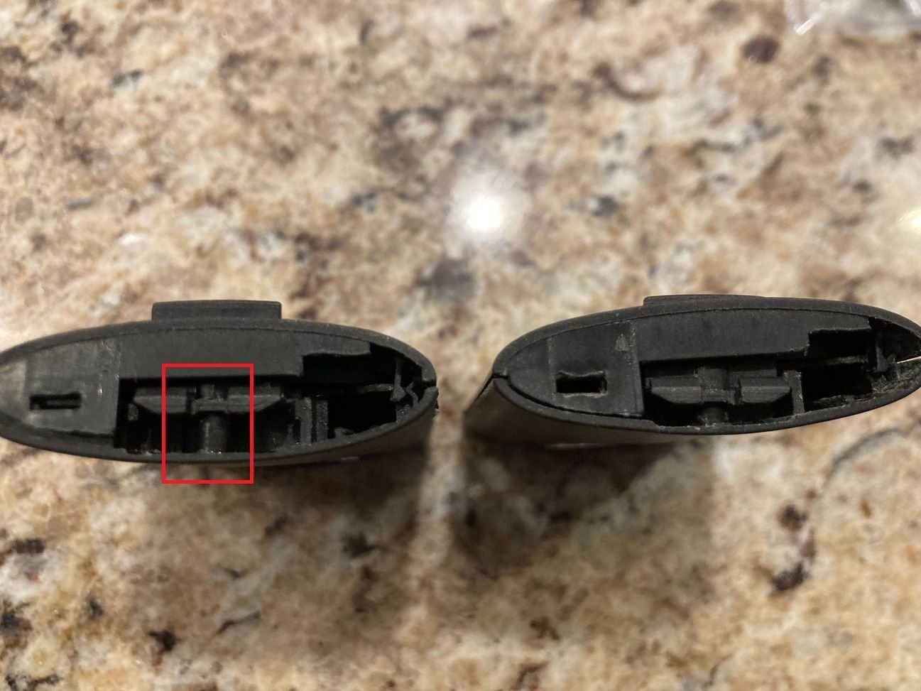

here is a pic of the two fobs. the one on the right functions as it should. the one on the left does not. notice the one on the left, the key release button sits further back than the one on the right. i think that is why it doesn’t work but i have no idea what is causing to sit that far back.

The button is not in all the way. You need to rotate it slightly as you are installing it so it goes all the way in, then rotate back to normal position. If done correctly, the button will stay in that half of the case without having to hold it.

I thought of that as well, but the pen spring is too big in diameter, so it won't work. I found a replacement spring, whose dimensions are close enough, on Amazon for like 8 dollars for a pack of 10.
