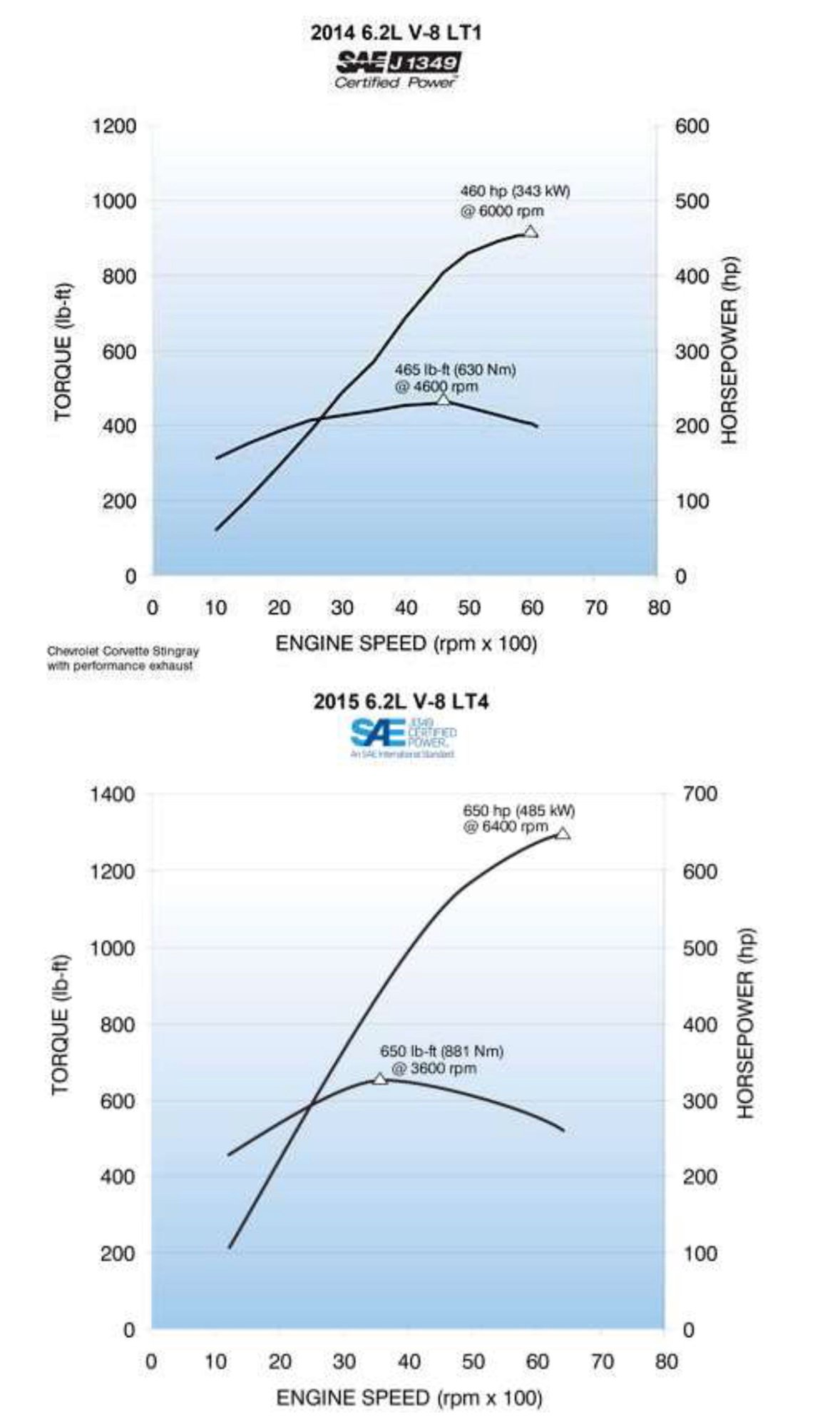

Since I have a Z06 my throttle response is different than the LT1 engine in the GS. Some of your throttle response problem may be due to the huge torque differences between a 97 M3 and almost any Corvette engine. They have a lot of low-end torque (even at 1000 rpm) and it comes on strong with small throttle movements.
As you can see the LT1 has over 300 lb ft of torque at 1000 rpm while the LT4 has about 450 lb ft of torque at 1000 rpm. Both have low-end torque levels that are greater than a lot of engines have for max torque at rpms ranging from 3500 to 4600 rpm with the LT4 being exceeded by only two or three other stock engines worldwide.
As you know even with an M3 poor throttle control can ruin a day at the track and the Corvette engines require even more of a feather touch to avoid purchasing part of a wall. They will do what you tell them to do almost instantly even though you didn't think you were telling them to do that.
Bill
Interesting, I have driven cars with lots of low end torque. Mainly they have been all FI engines and not N/A. Still this was a very clear ON/OFF feeling, it very well could have been that the nanny's were on. Seems like I'm right in assuming it was partly me and very maybe the car's history being a bit of an unknown it will remain a ?? until i try another. Unfortunately there are no other M7's near me. I have the 8l90e in my ctsV and I for sure do not want it in a vette if I am going to get one.
