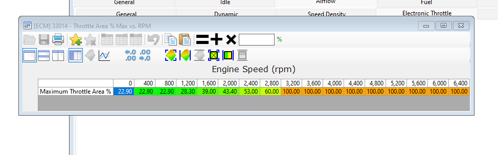

Here's what the throttle map looks like in a stock 2019 GS. Guess where you feel the "on/off" switch....

LOL, am I seeing that right? WOT commanded at 3200rpm???

There's some blending that occurs but that's the base map.
This is why the throttle controllers are popular.

Assuming I find a GS, I might just spring for hp tuners vs the throttle controller. Seems the market is rather lukewarm.

The only thing I'd suggest is that you get used to the car first. Even if you have the car in "Track" and the PTM mode set to Sport 2, you'll feel and hear the throttle intrusion at corner exit...."blat blat blat blat" sort of thing. Once you're used to it, you'll find you can put the gas pedal on the floor and let it do its thing. Once you're at that comfort level, go to PTM mode "Race" or decide to start mods. It's a very capable car.
You may figure out what fits your driving style and needs in a single session or it may take several track days. Experience certainly plays a role but so does how hard you drive....ie 7/10s and having fun but not worried about being the fastest guy out there vs running 10/10ths on the ragged edge after FTD and/or a personal best every lap.
