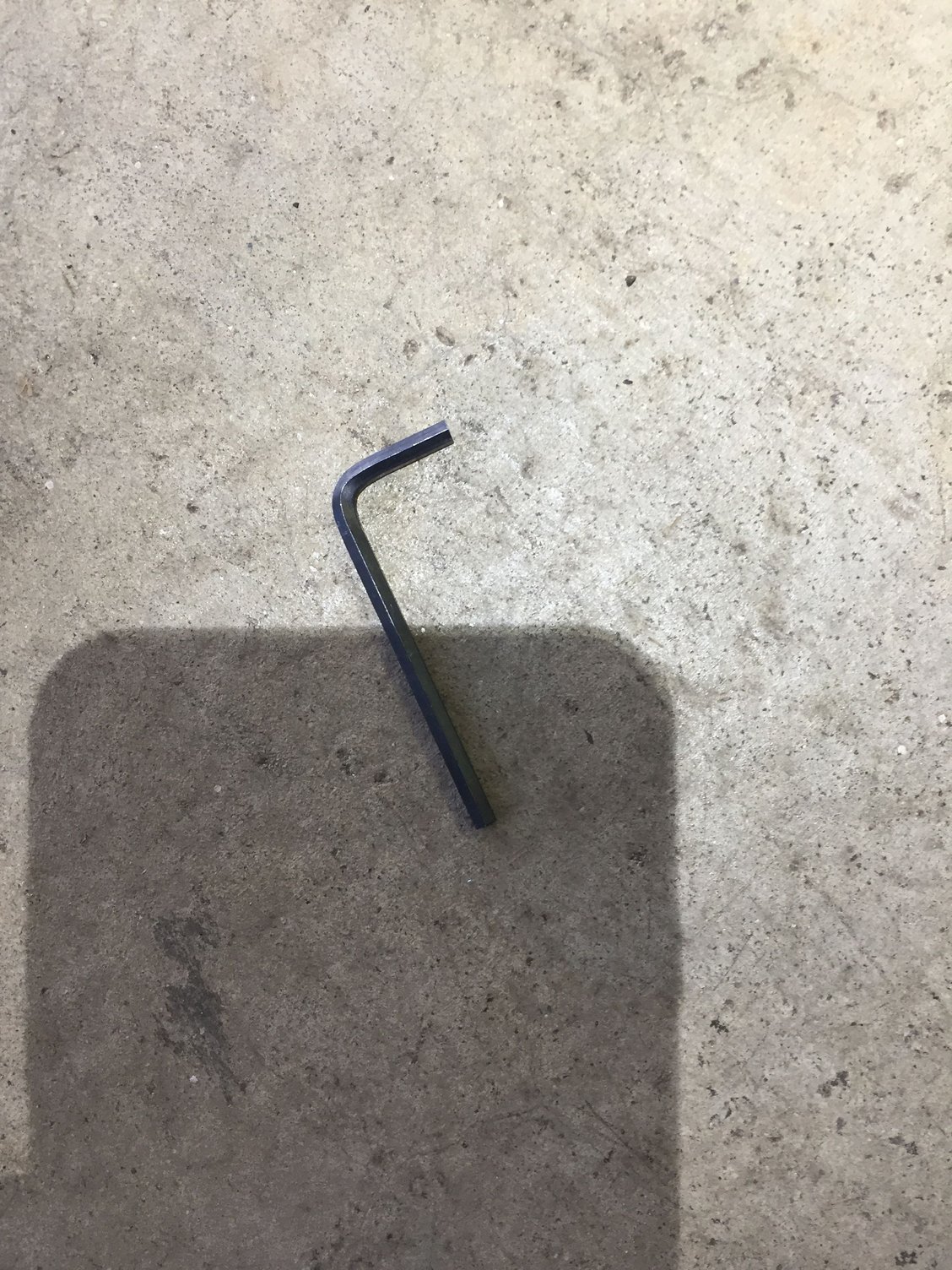

One of the trickier things was getting the boot off of the stock shifter. Attached right below the ****. You are supposed to be able to lift up and turn the ring it's attached to, but it can be a challenge to do this and not damage the leather. In my case the boot was attached to the right with some small staples, and those bent, releasing the leather with no damage! Others might chime in with their experiences.
By FAR the thing that took me the most time was digging out the small allen wrench I dropped down the tunnel during the install. Luckily I had a borescope and a magnet, but it was a real pain. Please stuff a rag or two into the space while you are working.

I took my time and it was right at 2 hours start to finish. It's not very hard, just some tight spaces to work around and those last few alan bolts take FOREVER to tighten as you can only go about a quarter turn at a time and you have to be really careful not to drop the alan wrench down in the space above the torque tube.
Other wise, it's pretty easy and you should get the alignment jig with the shifter.

Dont drop your allen wrench. A micro fiber towel around the shifter will help so that doesn't happen.
