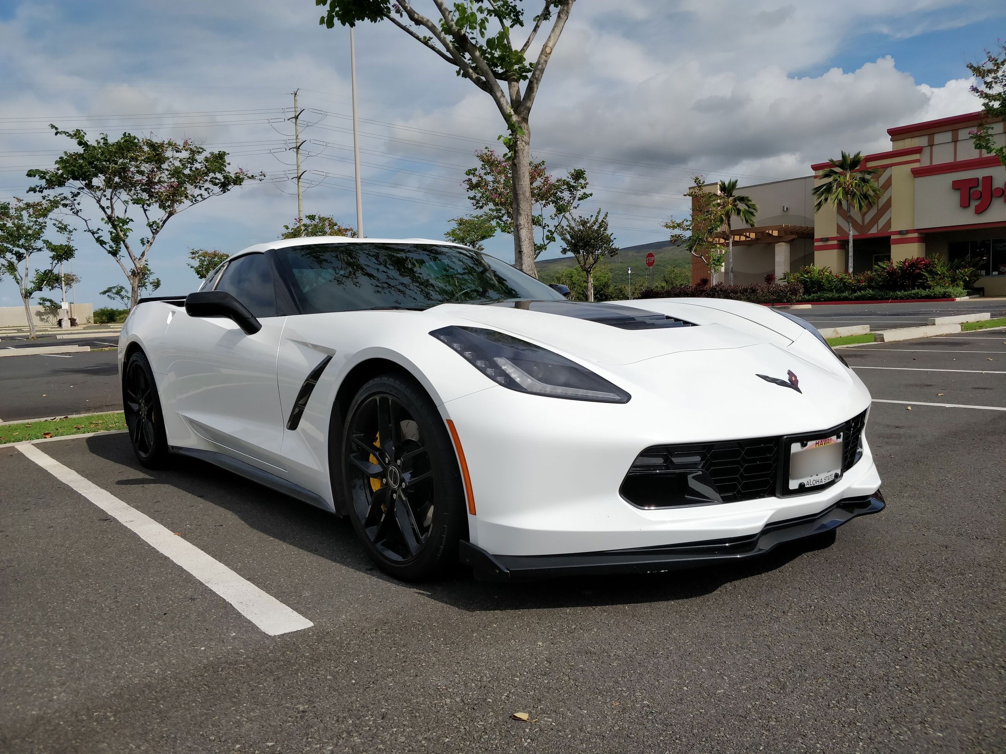

Here she was. Right before I sold her I put 20+hrs into the paint/ceramic coating
