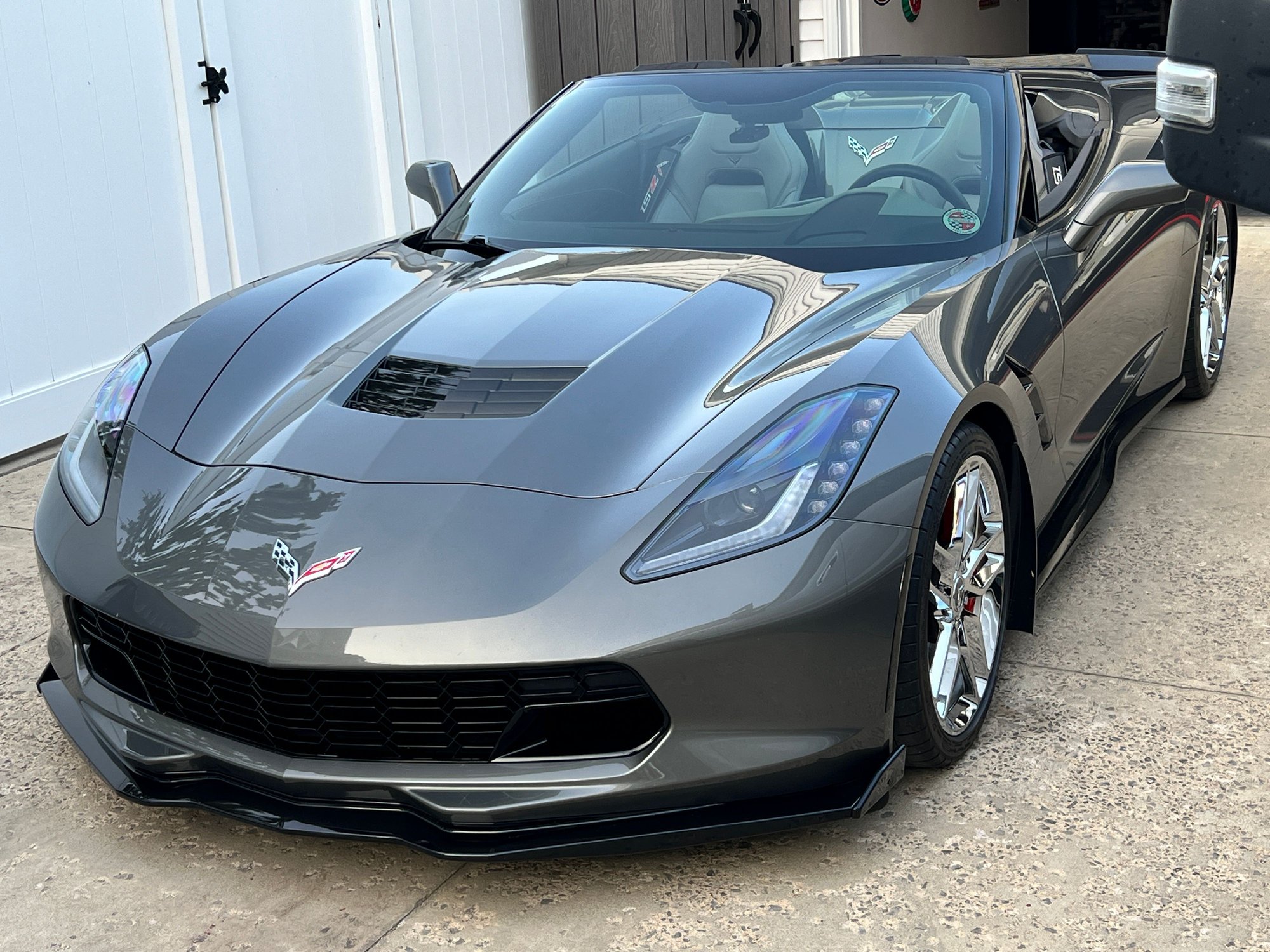

Mine came with the nuts and bolts but I hated them (too short) and so I used Home Depot hardware as well. They did you a favor.
Stage 3, but same bolts and same middle... For the cost I am very happy with the fit and finish. I don't spend too much on splitters since they will eventually need replacing!

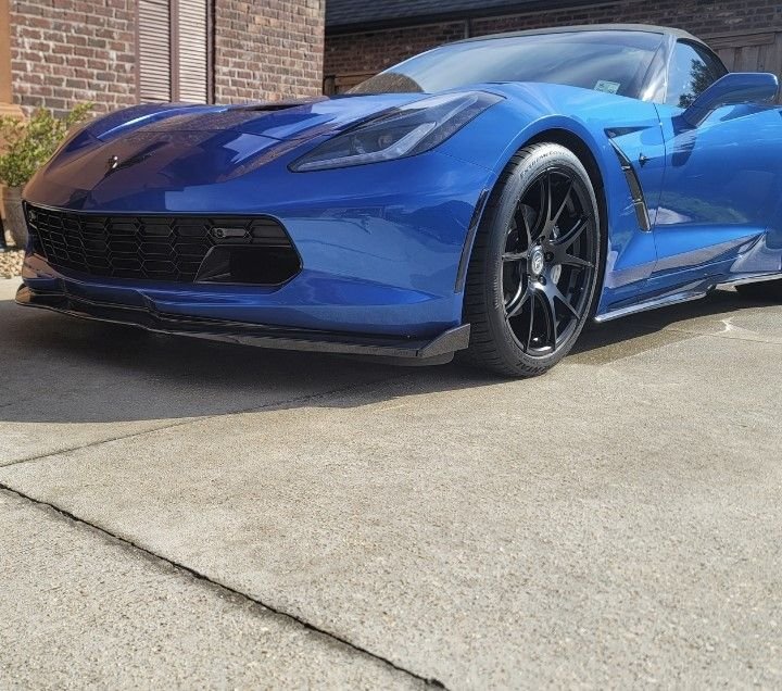

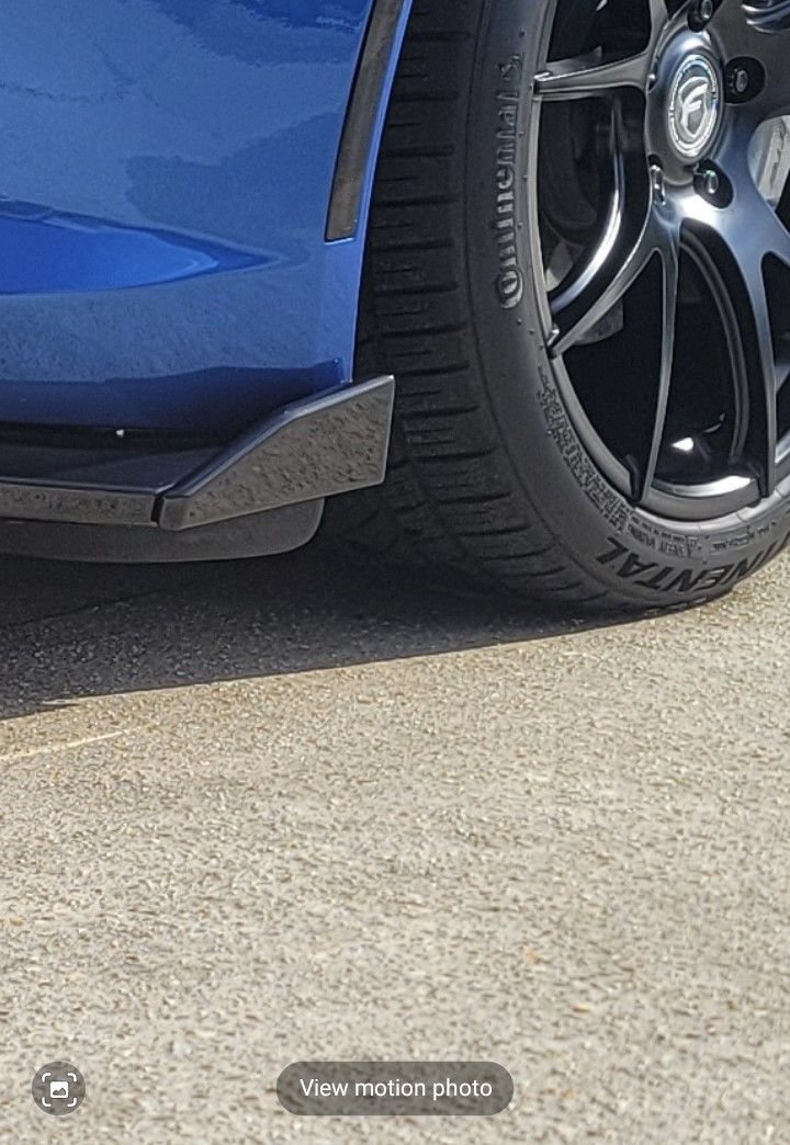

I used 3m taps and 3m tape primer, have been through the rain several times and speeds upwards of 160mph.. I didnt like the screw idea either so I did alot of research. It just sucks you already screwed it or I could have sent you a procedure and parts list to do it like mine
