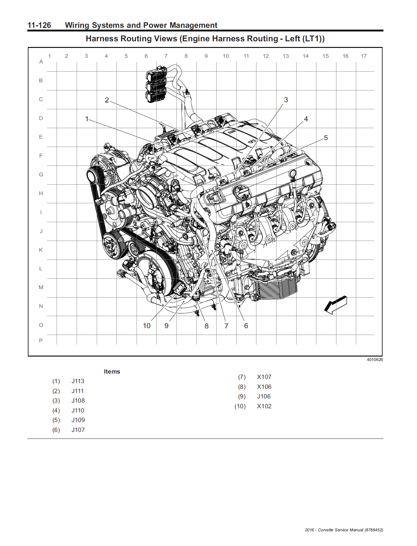

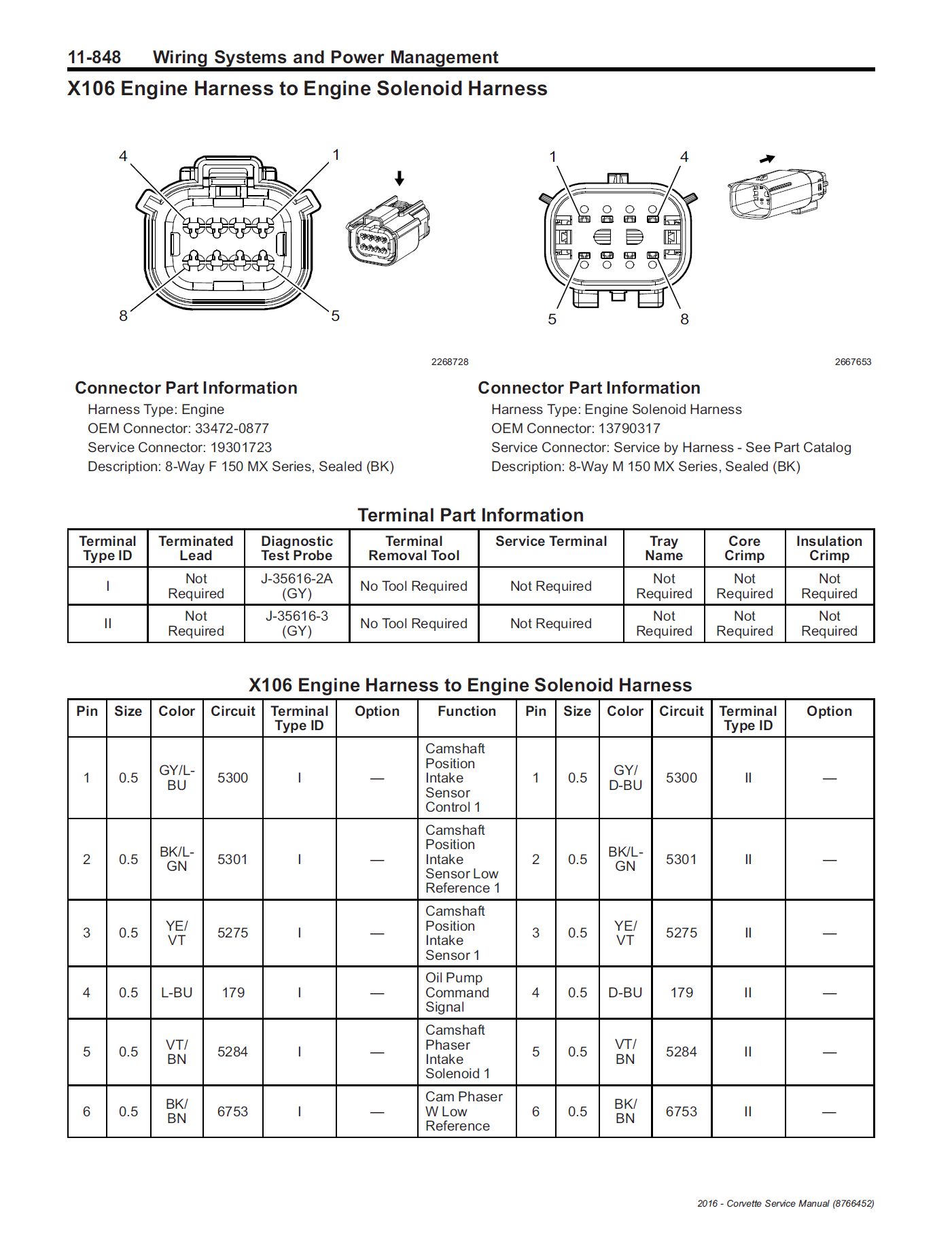

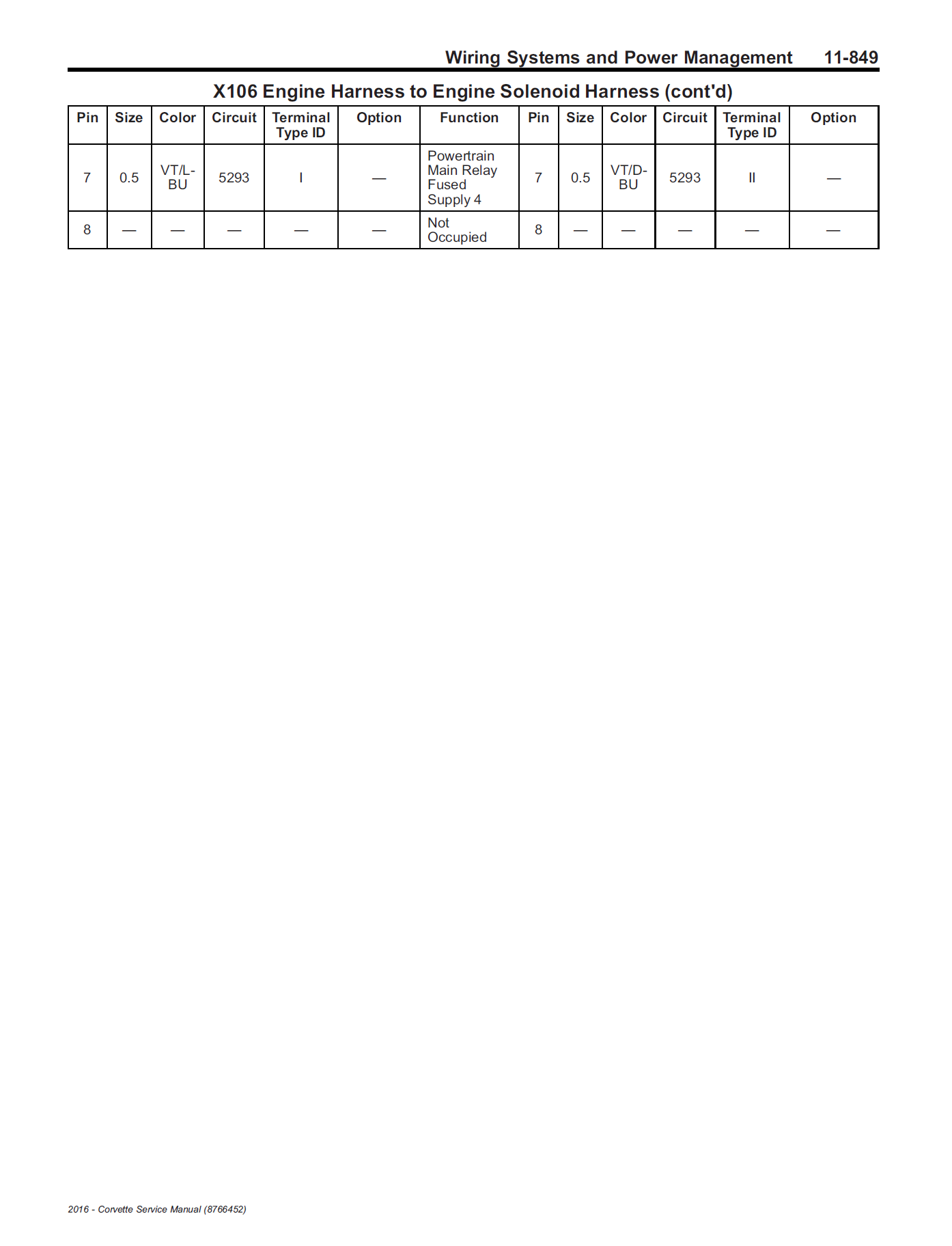

The problem is more than likely in the connector. Fixing the connector could be difficult due to where it is located. In addition to purchasing the connector, you may need to purchase the tools used to push connector pins out of the connector and into a new connector. Remember, X106 is a connector half that is part of a harness. There is other half of the connector is on another harness or module. Either one of the connector halves could be an issue. I don't know which half (male/female) the dealer is proposing changing. To repair/replace the connector you may need to remove the harness anyway, then the choice of whether to replace or repair becomes moot since labor and parts charges to repair are likely higher than labor and parts cost to replace.
If you can access the connector and disconnect it spraying the contacts in both halves of the connector with electrical parts cleaner and connecting/disconnecting/connecting the connector 4 or 5 times may resolve the problem. The multiple connections help clean residue from the pins.
From the FSM:
Bill
