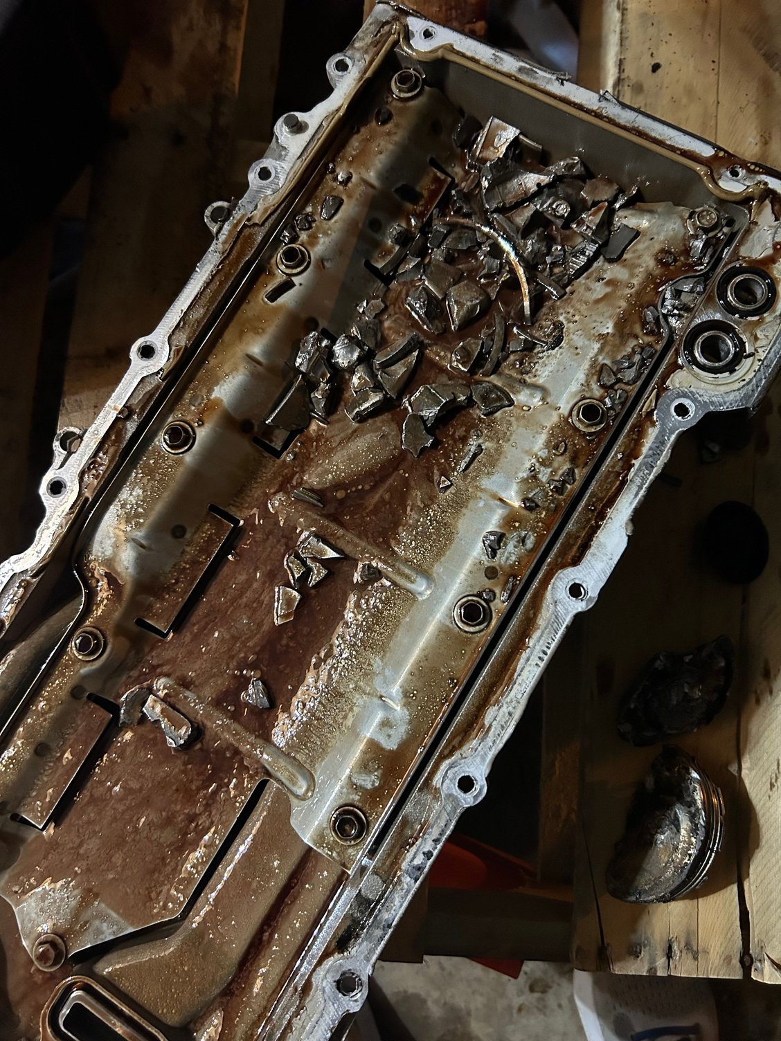

Finally got the motor out last week and that’s the impact of the dropped valve. New motor will be here today. Going through the parts list the only component I can’t find is the throwout bearing. Everything I search seems to comeback with slave cylinder? Putting the new (used) engine in I wanted to replace pilot, rear seal, clutch, and throwout. Anybody know what part number the throwout is or is it replace the entire slave cylinder. Clutch is being replaced with the McLeod.

Wow, that is some serious carnage! Was just looking at your thread title, "Possible" Ending Failure - no doubt now

If you haven't already, I Strongly recommend you pull the oil lines and the dry sump tank. All will need to be flushed. Ditto if you have the oil cooler located by the filter (or anywhere else for that matter). Basically all oil lines need to be flushed or replaced.

New (used) engine in and it runs smooth. Only major issue now is the permanent DTCs that haven’t disappeared yet so still have the check engine light. Only driven about 130 miles so far. I’ll keep it going until it resolves. One thing picked up was the fuel rails between the 14 and 17 years. My original 14 used a 4 wire plug in when going to the fuel sensor. The 17 used a 3 wire. Initially after the engine install I had a huge stall in trying to start. After I switched out the sensor and wire bundle on the fuel rail it fired right up.
