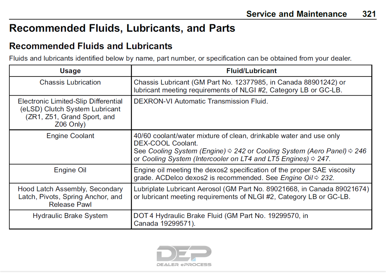

What engine oil do you recommend for 2019 Grand Sport?'
A previous Forum sticky" quoted a message to dealers that recommended using Mobil 1 for oil changes, under the Chevrolet Customer Care program, on 2014-2015 C7 Corvettes. That message was dated 2015.
My 2019 Owner's Manual says something different... recommending AC Delco oil.
What do you recommend?

Mobil 1 0W40 was the factory fill and is what is carried at GM dealerships. The AC Delco oil is the same thing. You can use other oils as long as they meet the Dexos2 specifications. For your car, you can use any Dexos2 5W30 and 0W40 on the street or on the track you can use 0W40 or 15W50. The ZR1 needs to have 15W50 when used on the track. The 0W40 oil gets you around the GM OM requirement of changing from 5W30 to 15W50 and back to 5W30 when taking the car to a track event for a few days.
