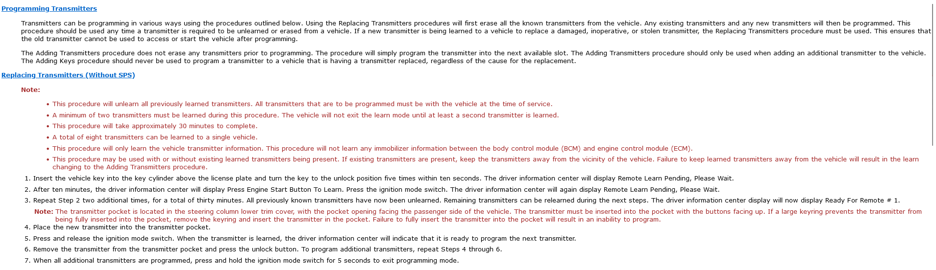

What's the battery voltage? I'd probably pull that out and have it load tested. Next I'd pull out all the carpets and dry everything out. Then I'd look at all the BCM connections. They should be weather tight so if the pins all look good, I'd test for power to the BCM. After that, I'd try to program the fob again. Since the fob is not being recognized, nothing will turn on.
If CoPart advertised the car as running and if the original owner said the car was running when they hauled it away, the BCM is likely fine.

It wasn't run and drive but the dash was all on in ad. Had locksmith make key but couldn't program it as the obd he thought was shorted as it shut his machine off. I took out bcm it was corroded. Gonna start with that and don't everything out. Only power I have now it when I manually open door corvette comes on dash that's it. Nothing else. My fat *** crawled threw roof in beginning to open the door

Did you try programming without SPS access....
