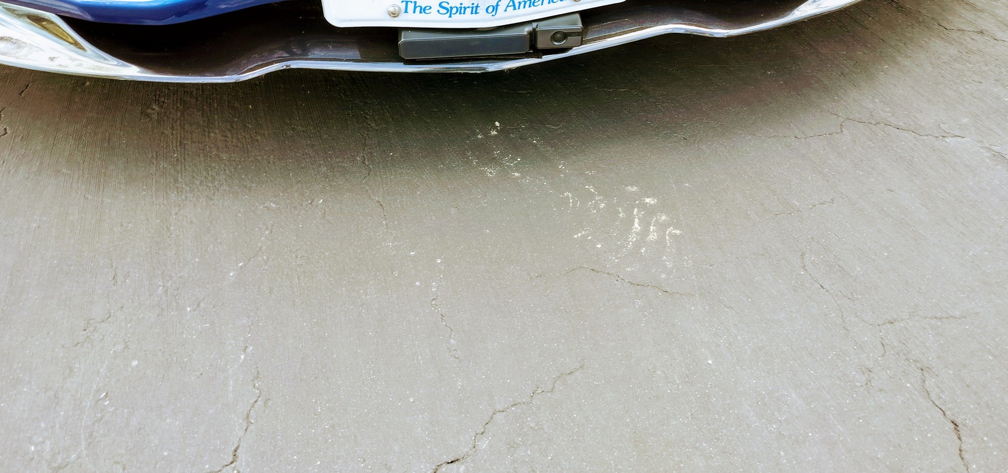

I didn't want to cut wires, so I installed a solar powered camera. It came with a 5 inch LCD that is plugged into my cigarette lighter. Very happy with it. My car came with an ACS Composits splitter. It was only matter of time before I destroyed it. Here is a pick of the LCD (1080p).
Camera below plate on splitter.
