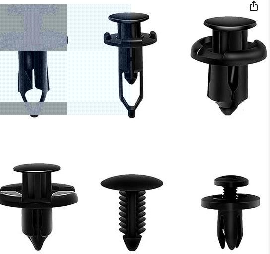

Not familiar with these 2-piece push pins. Any pics of them? I need to replace my front spoiler soon.
NAPA, O'Reilly's, Autozone, etc, will have small packs of various styles/sizes of these hanging on their racks -

I'll offer that since the OP lost the splitter due to an on-track incident....**** happens....plastic clips are not going to secure the new splitter. GM uses aluminum split rivets. They are available on Amazon for much less than you can buy them for at the dealer. These are the same rivets GM uses with the side skirts.
