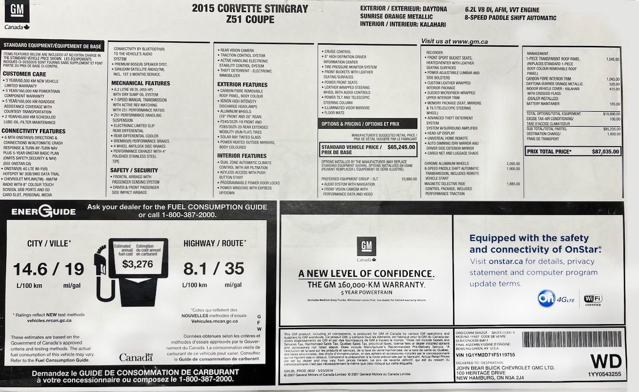

New to the C7's, and not trying to hack the OP thread.
I have "7-Speed Manual Transmission with Active Rev Matching with Z51 Performance Ratio" on the window sheet, then it has 8 - Speed Paddle Shift Automatic also . I know it's an automatic. Car has 9000 KM (5500 M) on it. This triple flush, is something never heard of till this site.
Sound like something I should look at ?
You have BOTH auto and manual transmission in one car?
No, that's just what is indicated on the window sheet that came with the car, not sure why says both, but it's an automatic to clarify. Under the mechanical features indicates "manual" , maybe I'm missing something.
Auto was the option the original buyer selected for $1000 more.
I would get it done before I get shudders. It's going to pick up moisture and feel fine till it does not. I'd rather have the hygroscopic fluid out before we get to the point of shudder since damage might be going on till it shudders. Why wait?
