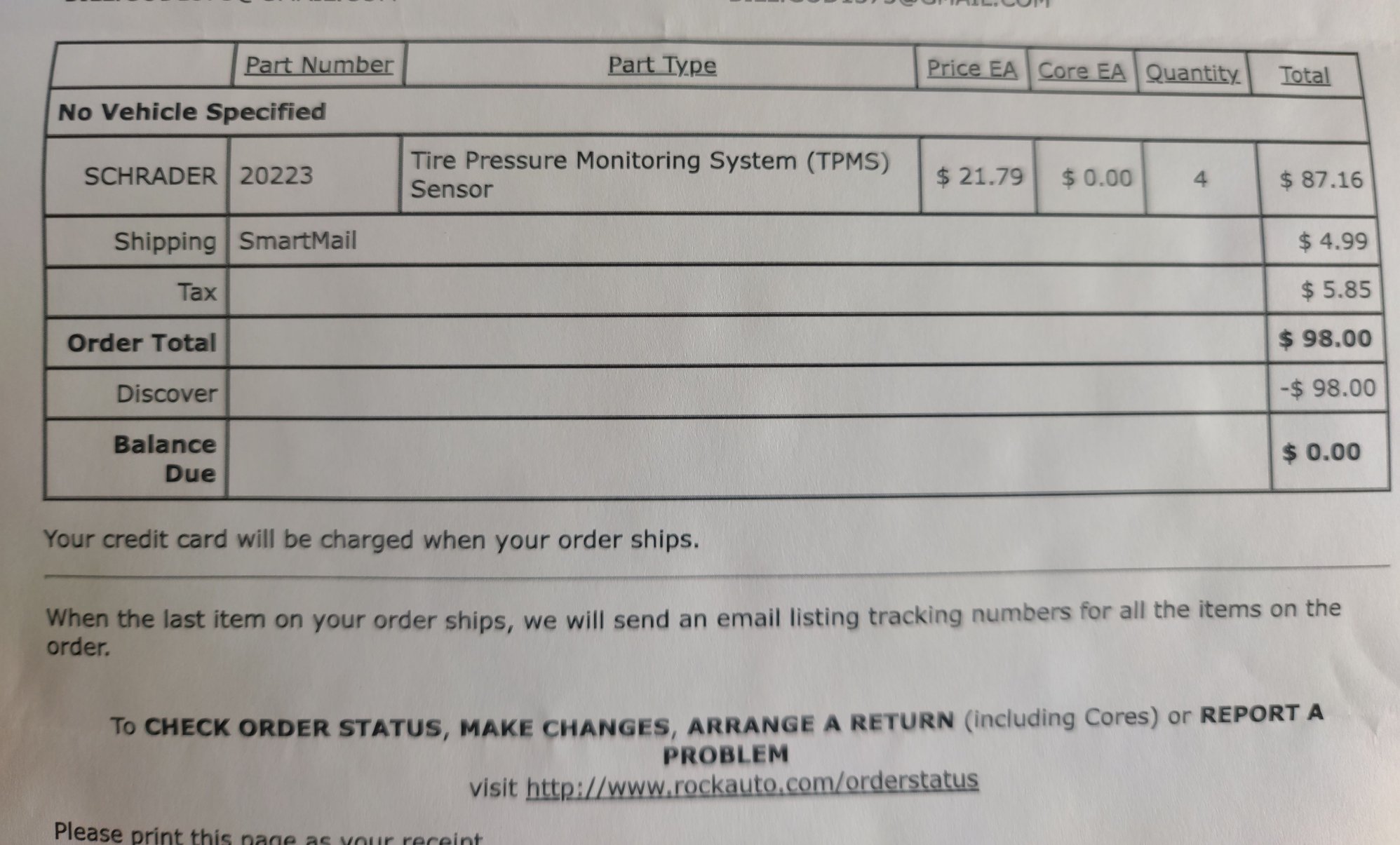

I ordered a set from RockAuto for my 2017 Grand Sport. Schrader, part #20223 and they work perfectly.
