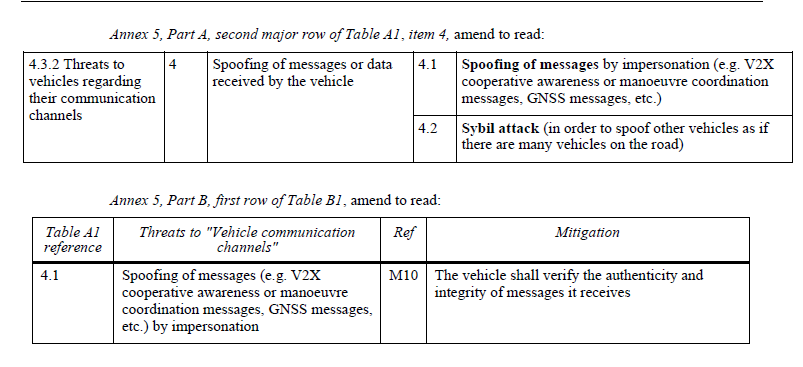

Originally Posted by Dan Hintz
No arguments from here on that one... I attack whatever they throw on my desk, but I've been in a vastly different area for the last two years. Your link was to a two-page addendum to the original regulation. I believe this is the original reg it's referring to, but I didn't do more than a few minutes of searching:
https://unece.org/sites/default/file...%20%282%29.pdf
I did a very fast scan of that reg, and I failed to see where they require CMA on the CANbus. In fact, it seems to be fairly generic/broad, requiring vehicle manufacturers to test/validate their systems from a cybersecurity standpoint, report once a year on those tests, etc., but it doesn't go into any detail as to what specifically they should test against (it almost reads like a self-certification, allowing the vehicle manufacturer to decide what's critical and what's not... "Yeah, we're good, we tested our own stuff and gave it a thumbs up"). Perhaps you intended to link a different doc?
You mentioned that CMA is causing issues with your legitimate access to the info busses... in what way? I don't get the impression you're actively trying to test these systems from a hacker's standpoint... if it's simply because the tools are crappy, that's not really relevant from a security standpoint, that's just poor tool design.
So this table makes CMA or a similar technology (there isn't another on CAN) required, its how you "Authenticate" and protected against Spoofing.
Thing therefore like Vehicle Speed or "Motion" commands are protected. However to test features you frequently do spoof signals, so now to spoof thing you need to have special parts that use "defaults" so you can spoof things. However later in programs everything is "productionized" so using real everything no "defaults" so no "spoofing" But also the physical networks are harder to get to, in prototypes we have special harnesses installed so you can plug in (most software debugging for integration issues in a vehicle is done by looking at CAN traffic to understand where in the interaction between modules is happening.
I'll use the C7 as an example because its old enough and doesn't relate to my current job and I won't be violating any NDAs or Trade Secrets.
In the C7 for example the Steering Angle of the vehicle comes from a sensor (called a SAS) in the steering column. This is a hall effect sensor that can detect the wheel turning. Since steering angle is the same as pinion angle (on the steering rack), the EPS uses this angle to know where the vehicle is headed. The EPS can internally keep track of its own movements (and does) but it has no "straight ahead" reference, hence the SAS. Corvette doesn't have LKS, but similar cars (ATS/CTS use the same SW and ECU for steering as the C7) do and this angle is used to determine if the steering system is doing LKS appropriately (same with Automatic Parking Functions).
The system its self uses Vehicle Speed (which comes from EBCM/ABS) to determine which boost curve you are on (proportional gain, effectively the same as the old hydraulic valve). Its also used to lock out specific safety functions (like the module will deny software flashes over UDS when the vehicle is moving). But the CAN Bus contains all sorts of data (and for each OEM its differently formatted). There are multiple types of CAN Buses, from Low Speed, Medium Speed, High Speed, and in newer cars CAN-FD. Signals are gatewayed by modules between the various buses, some companies like Ford use a central gateway, GM on the C7 has multiple gateways. EBCM does the job from the main HS-CAN to the CE-CAN (which is also HS but CE stands for Chassis Extension).
The **** to switch modes is also another CAN signal.
So imagine you are in an early prototype and some of the other modules have bugs that prevent proper operation. Like lets say mode switching is broke. You can in theory disconnect the switch and spoof the signals to do your testing. You'd use a tool like CANalyzer, CANoe or CANape (all from Vector) to do that, or you can run a more custom solution.
In newer cars these signals (LKS Request, Park Aid Request, Vehicle Speed, and Angle) are all authenticated to prevent spoofing. Since by spoofing some of these signals you can have control of the vehicle or do "unsafe" things like update a module at speed (which can cause a loss of functionality).
The point is that this stuff if also much more terrifying than someone man in the middle attacking your car to steal it. I don't worry about this stuff. So I don't worry about theft.
I also don't worry about what happens if someone working on EPS does their job wrong and has a unintended steer event where the motor goes max torque in one direction (imagine that at 70 MPH). If you don't worry about that stuff, you should also worry less about some thieves copying your key.
