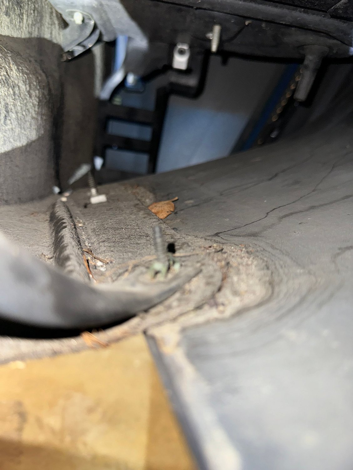

Hello, I finally purchased a 2014 Stingray 1LT! I’ve been looking forward to it for a long time. I’m having a bit of an issue though. There’s a metallic tapping sound coming from somewhere behind the driver, and I can’t seem to find the source. I’ve tried checking all the hardware keeping the hatch on/dampers on and I’ve adjusted the targa top, which did remove a squeaking issue, but I can’t seem to isolate the tapping. Do ya’ll have any suggestions?
Thanks,
Ken

Welcome to the ever tapping, clicking, ticking, popping, top, C7. I assume it isn't a rhythmic, tap tap tap, but only happens over bumps.

Thanks! It’s definitely not rhythmic, but it only happens when I’m going 50+, even on smooth roads and highways.

Found the culprit. It was a broken clip that attaches a brace to the lower bumper on the left side.

Glad you found the source of the noise. Pretty good investigative work to locate it.
