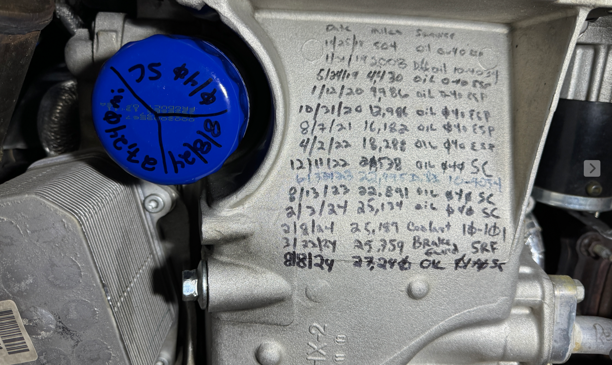

I use ESP and now Supercar as it is what was called for (and probably change it more often than needed).
Love your record keeping.

St. Jude Donor '07-'08-'10, '14
Thanks man, I don’t usually keep them this long and am running out of room! Haha
You know something, I actually like what you're doing there.
I never thought of doing this, and it's pretty smart actually and I'd imagine a bonus for any 2nd or 3rd owner down the road.
