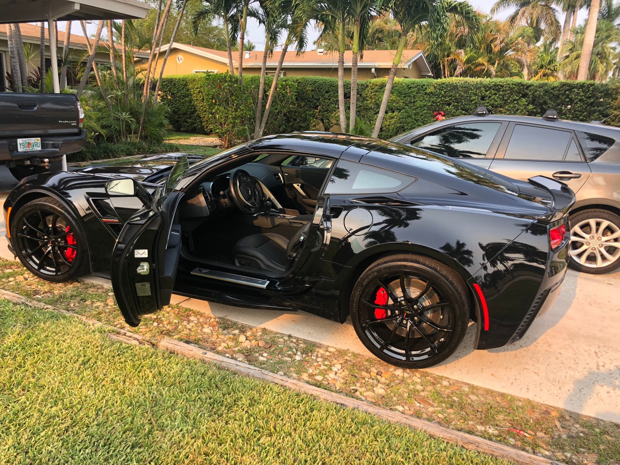

I just wanted to let everyone know that my son lives in Hollywood, Fl, so dealing with his car issue is put on hold temporarily as running his business is more important.
The situation will get resolved one way or the other and as soon as it does I'll post the results here. Thanks again to everyone for their responses and help. I live in eastern Tennessee. Our weather is supposed to get real nasty tomorrow which may result in power losses in the area. Wherever you all live I hope you're high and dry and safe. Meanwhile here's a pix of my sons car so you can see why you're helping. You all have a good night and stay safe.
2019- 7 Speed Manual- Approx 2500 miles
