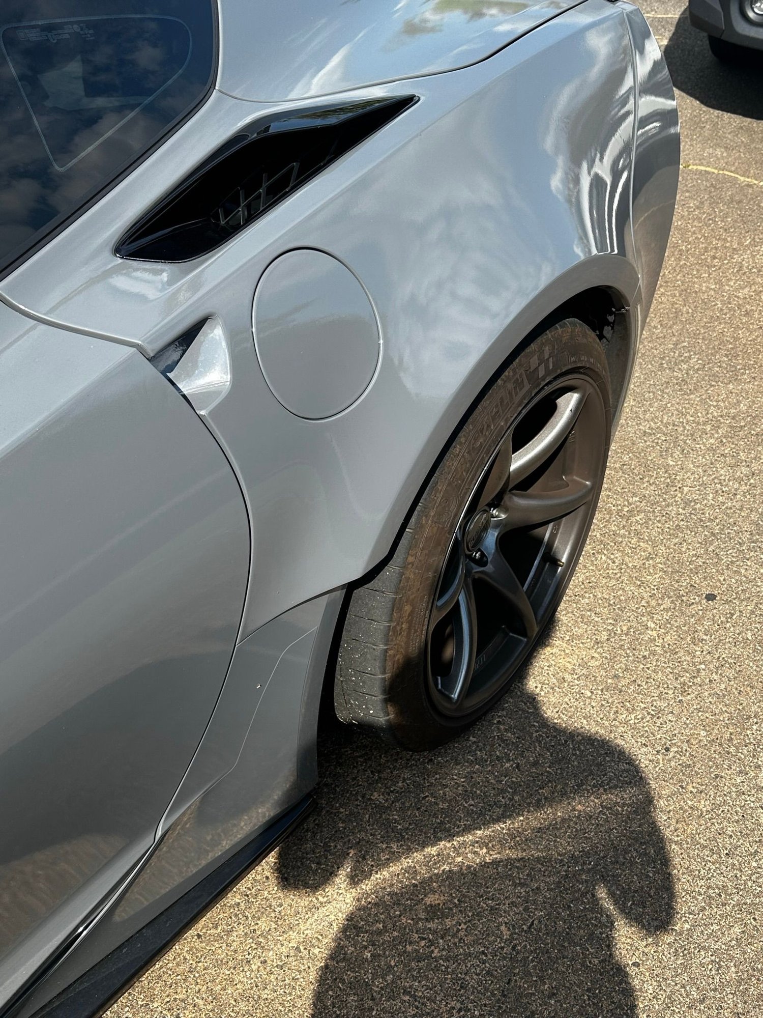

yeah, that's it. Now keep in mind, there will be a slight gap between your rocker panel and the new wider quarter panels. Unless you want to go through the hassle of buying the rocker panel extensions and having to cut the body and bolt them on, I would keep it that way. After all, I enjoy the look of the widebody without rocker panels more because you can see the meaty tires from the front of the vehicle. I have listed a link to the rocker panels and attached a photo of how the widebody will look without it.

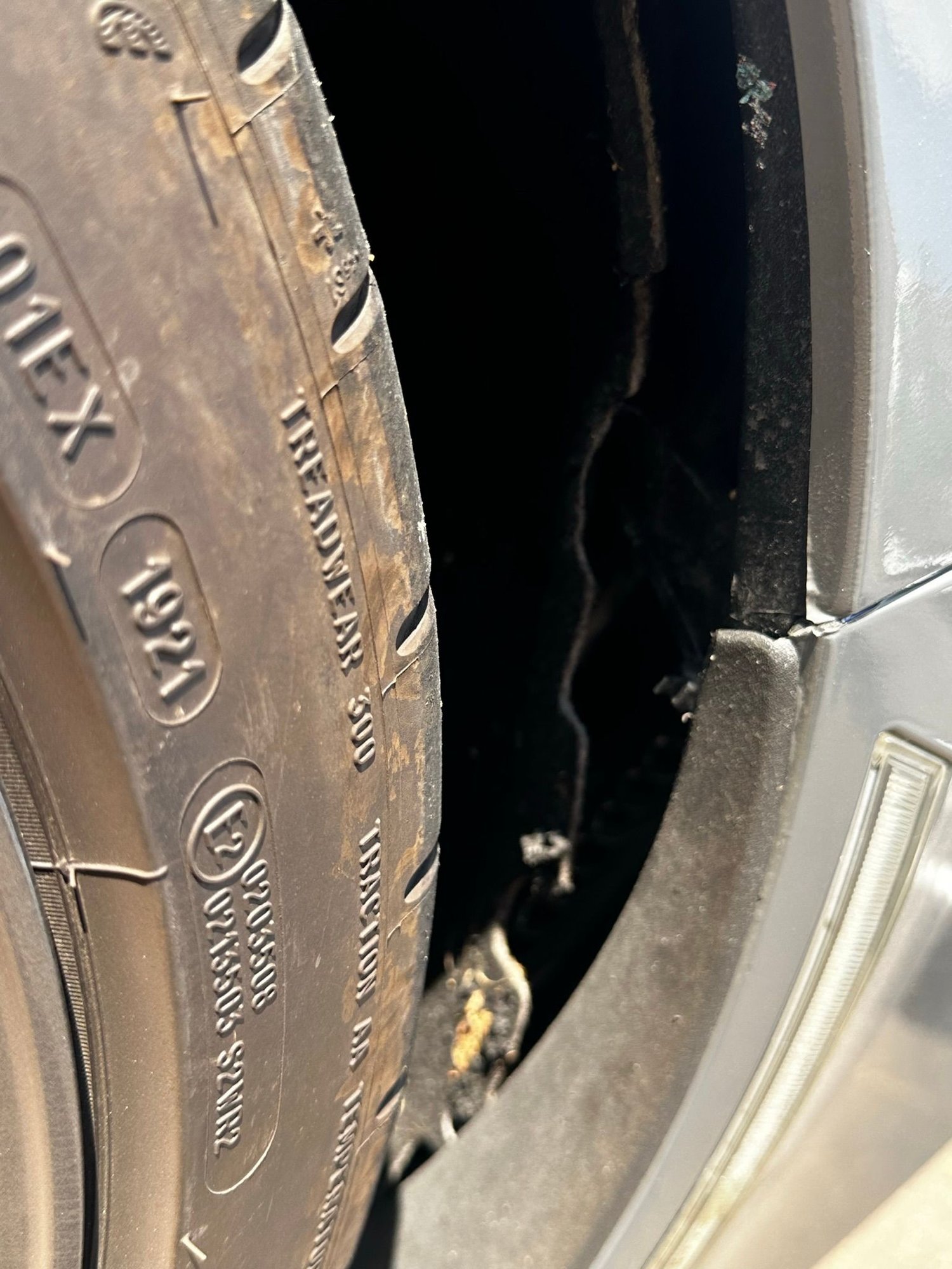

Congratulations. You have installed the Z06 kit. There are a few things you may notice. For starters if you did not get the Z06 fender liner, you will notice a gap from the slim fender liner and the Z06 qp / rear bumper. Personally, this does not bother me, but it may for some. If you do get the fender liner but you don't get the rocker panel extensions, you will notice that the fender liner will stick out where the rocker panel is supposed to be. you can cut your wider fender liner with a saw Zaw and make it work with the slimmer rocker panel. Next, your quarter panels and rear bumper fitment may be a little iffy. THIS IS GOING TO HAPPEN. after all, your installing panels on a car that aren't supposed to be there. there will be little gaps between the body panels. For me, i used zip ties underneath the quarter panel / rear bumper and it gave me an OEM finish that made me happy. I will attach photos of the fender liner gap below.
