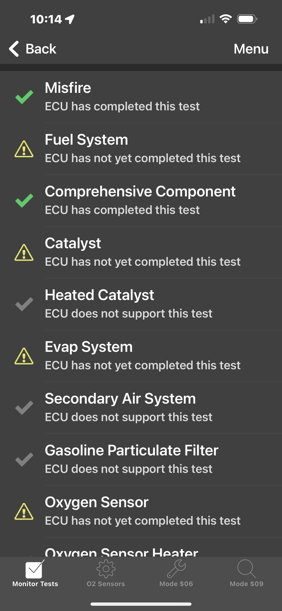

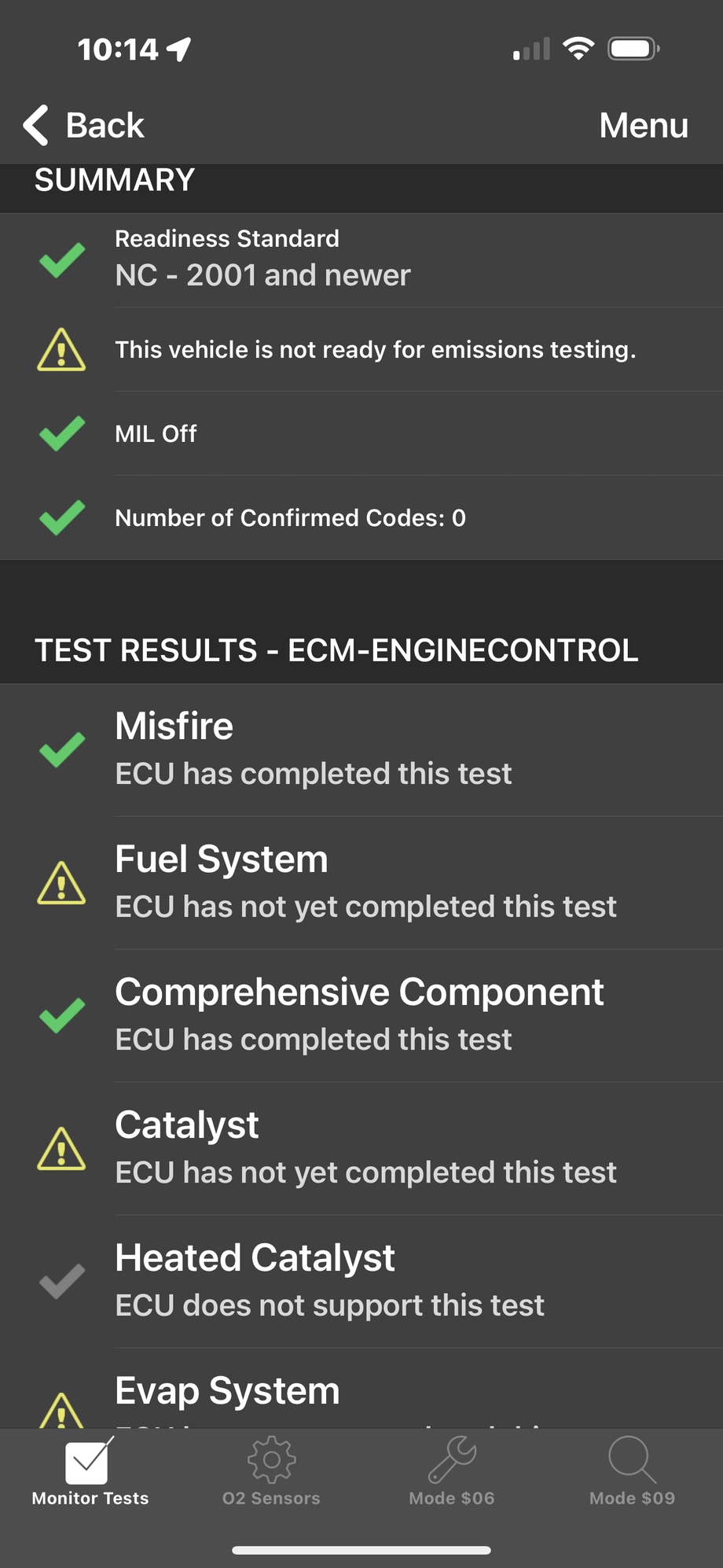

I also have a Range Device but it gives me problems at Inspection time. The car reports NOT READY for State Inspection. I have to remove the device and go through a painful process described by GM to make the car ready for inspection. I don't see that problem with the Carbyte. I now have 2 released products and they work better than my beta test unit and there is a phone App to connect to them.
These are from the same company that manufactures scan tools (scantool.net) that I have been using for years. I currently use the OBDLink MX+ version. Works great with an iPhone. That is the tool that I use to see if the car is ready for inspection before I go to the dealer.

Range help desk recommended remove device and drive car 3 times before inspection. Worked for me.

Yes, many of the sensors have not completed calibration. Three vehicle cold starts were not enough for me so I had to resort to the GM Process two years running.
It is not clear to me why the Range device needs to do this. I can remove the Carbyte and use the scan tool to check the sensors and they are not disturbed.
Photos from scan tester screen shots after multiple cold starts.
