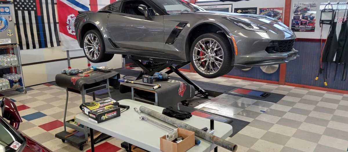

Had some of the fellers over today for a brake pad exchange from dusty to Power Stop ceramics. Normally, taking off the wheels are done by hand, breaker bar, etc., then put back on with a 100 ft pd tightening. Getting a wheel off, not happening, could not break loose any of the lug nuts. Tried a 600 ft pd torque impact gun, nothing. Used a 4 ft long steel pipe on the breaker bar, again......nothing.
Owner is taking it back to the tire shop that did the last tire / wheel work on it. Someone screwed up, I see an *** chewing coming up on proper torque tightening.
