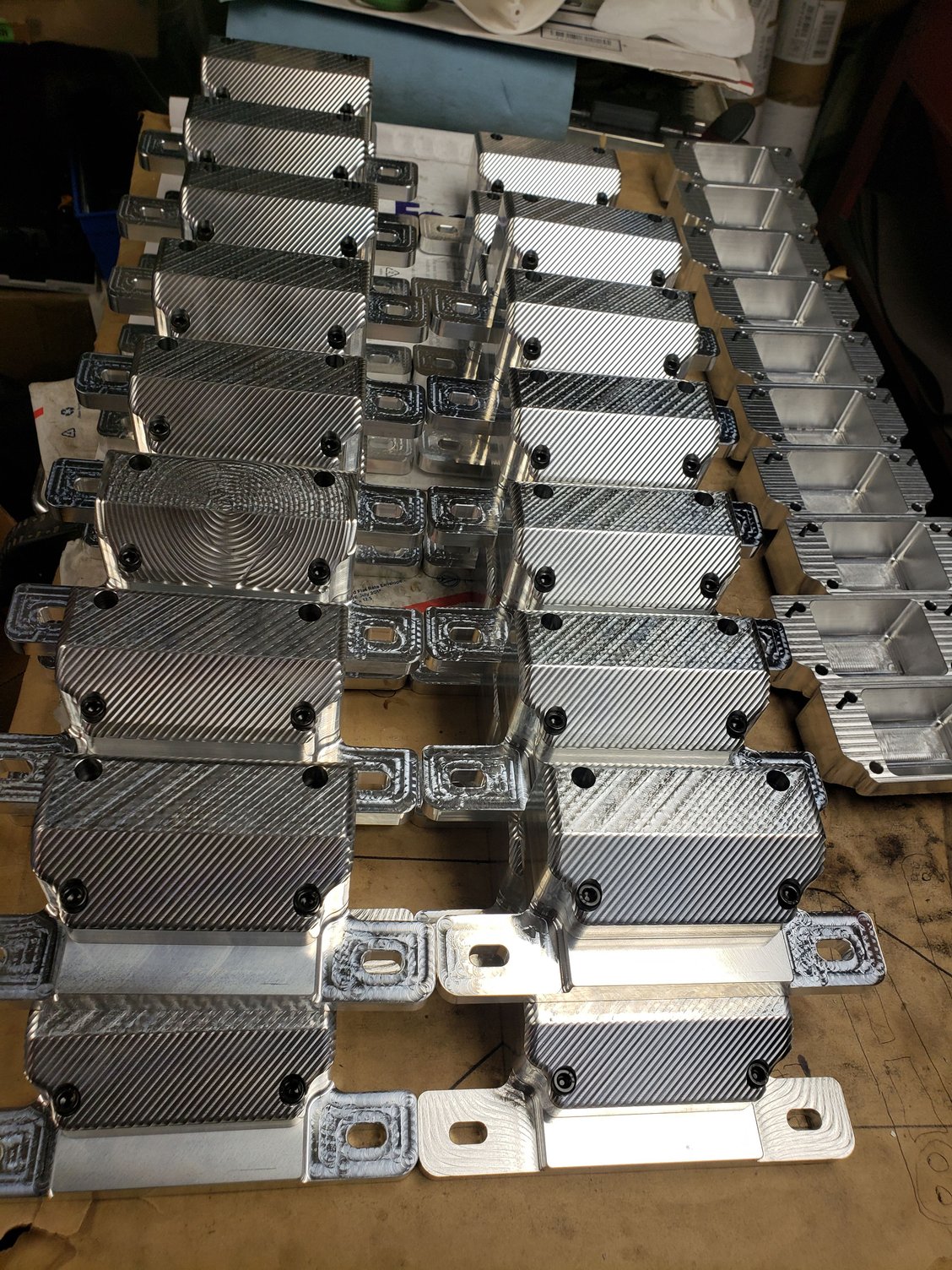

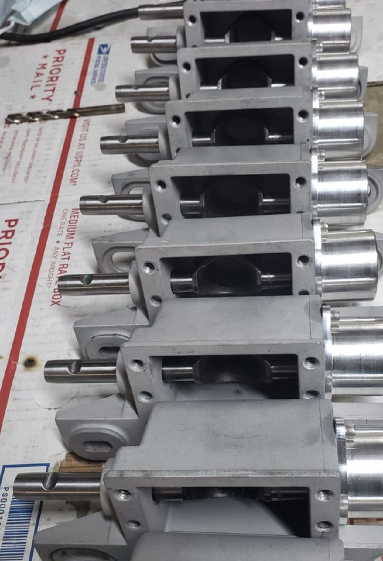

The issue is due to two different possibilities, both are typical not common. If your having trouble getting into first or reverse the first thing to do is the bolt on the linkage, it needs to go back together clean with RED Loctite on the threads. This bolt comes loose over time with heat cycles and it allows the shaft from the box to slip that collar. It's hard to see if your not paying attention; the shaft, right at the end of it's travel, will slip inside the collar.
The other issue is wear; primarily in the box. As your box wears the internals of the box that secure the shaft and the torque tube bushings (non-Z boxes) that mount the box to the tube develop slop. Slop increases with age and mileage and you eventually develop issues getting into and out of gears. You can play with the alignment of the box / shifter and get it to work better for a while but as the box wears more you'll be pulling your console out to readjust.
Upgrading the box eliminates slop / rattle and makes any shifter your running smoother and more precise. If your running a shifter that uses the factory bottom pivot bushing, which also includes most of the aftermarket shifters, I have a better bushing that makes a significant difference a well. Upgrading the box / shifter bushing makes any shifter feel considerably better than it did when the car was brand new and it will last the life of the car, guaranteed.
