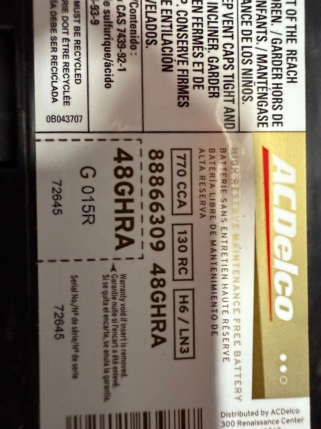

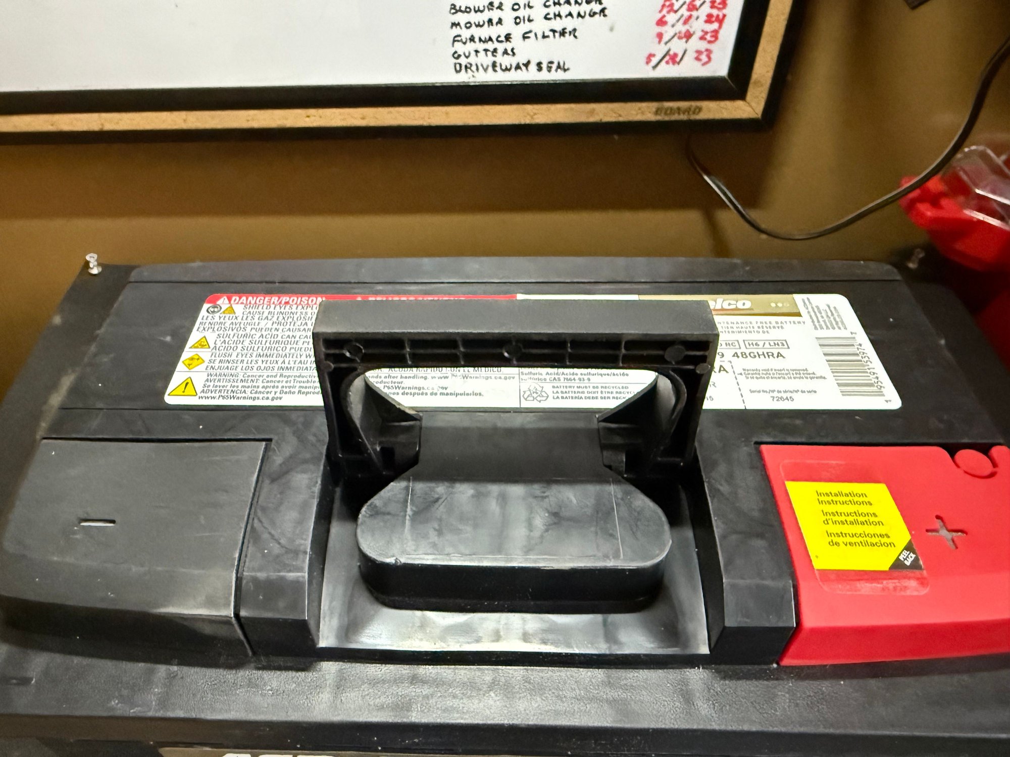

just picked up a ACdelco battery from my local dealer and wanted to double check that it is the correct one;
1 I thought the battery in ours didn’t have a lift handle? Or is that only the one with manufacture?
2 I wanted to double check the date code -the 01 would be January?and the 5 would be the year? It’s not 2025 yet, so shouldn’t this be a 4?

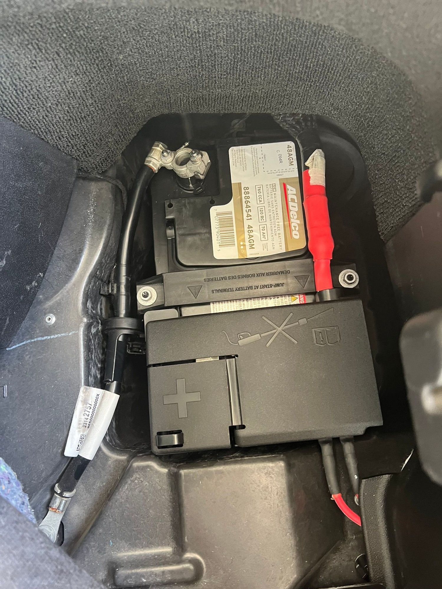

They sold you a standard battery which is fine. On these batteries, usually the date code is stamped into the case near the positive terminal. I do agree that normally G=Gold, 01 = January, "5" = year....and hopefully not 2015!....and "R" is the plant
Below is the AGM I put in mine a couple months ago....

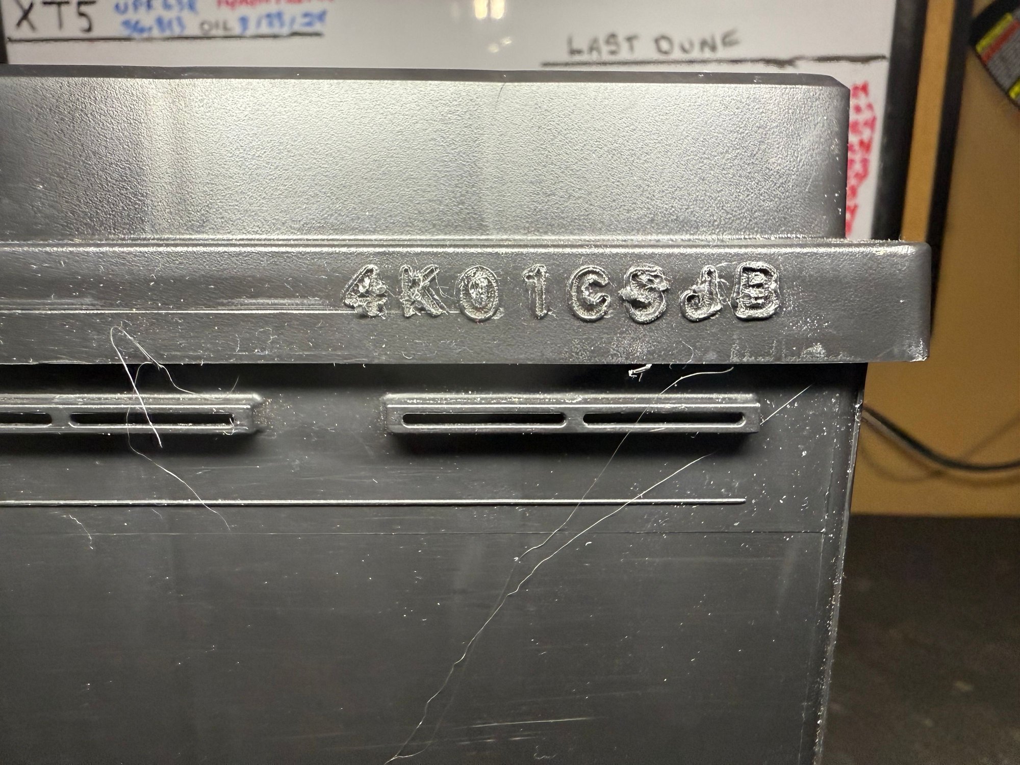

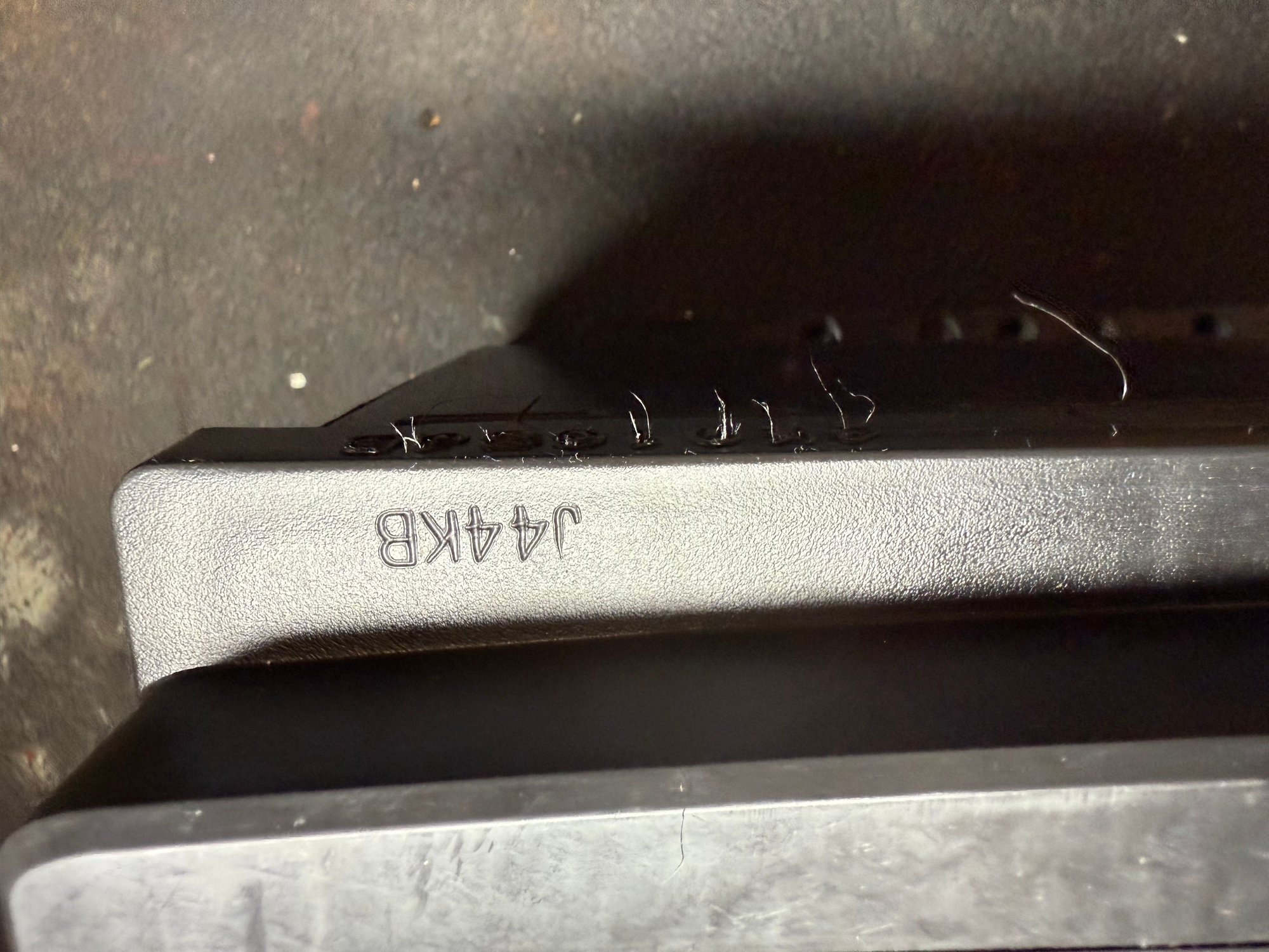

Here are numbers that I could find on the case

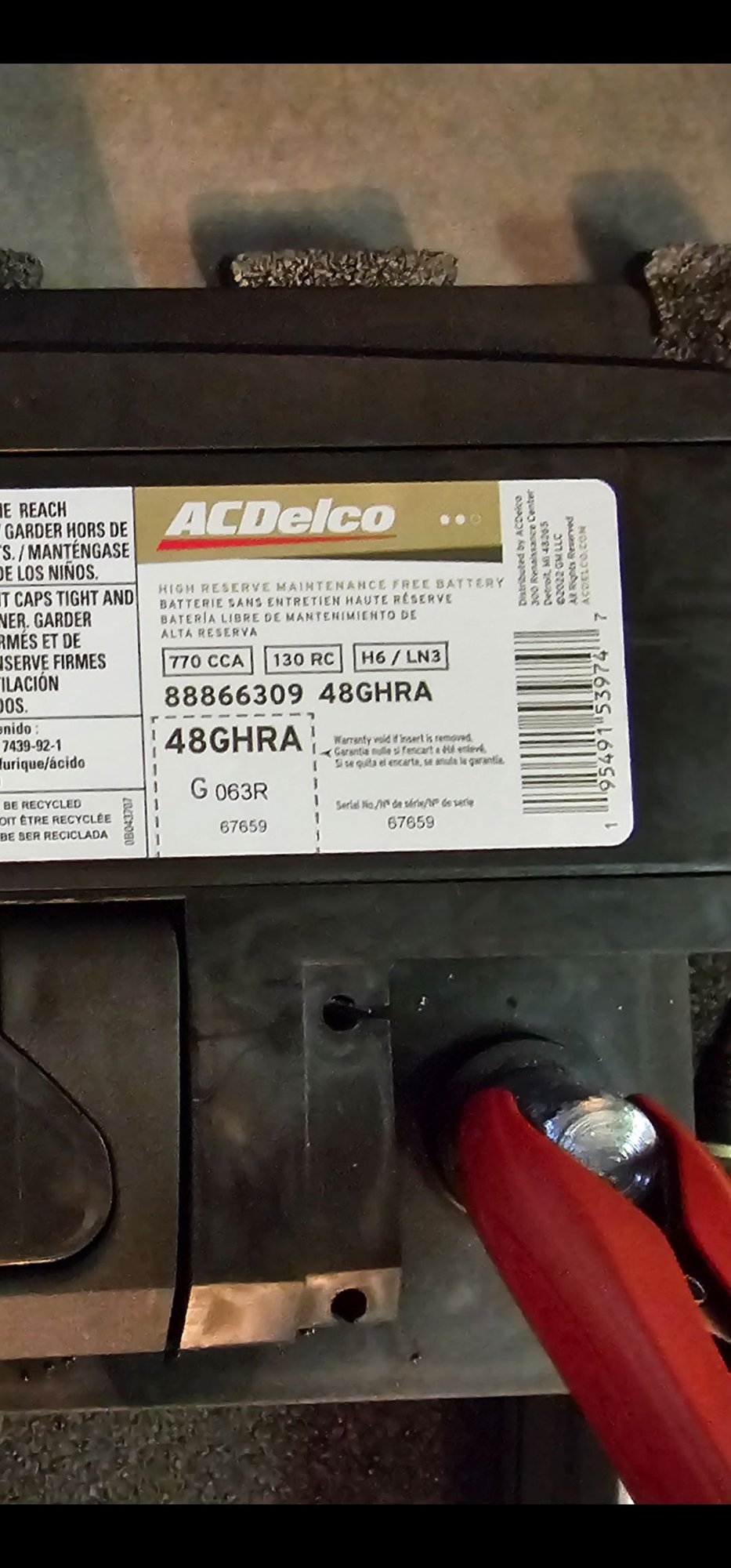

Your date code does not make sense. I replaced my battery last year. The date code G063R indicates the battery was manufactured in June of 2023.

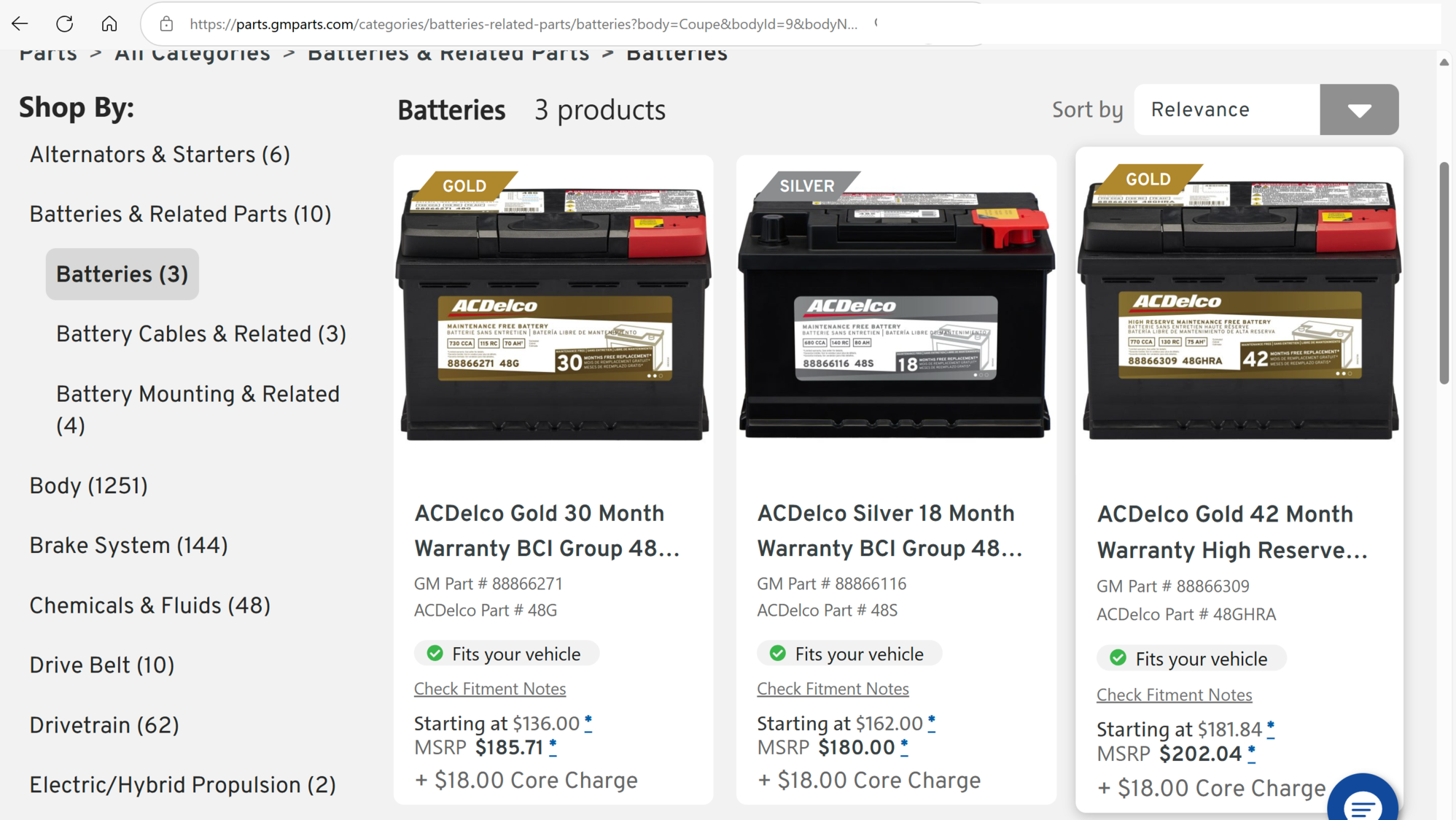

GM doesn't recommend using AGM batteries in the C7 because the charging system isn't designed to support them. The charging voltage can go higher than appropriate for an AGM battery. The picture below shows the three batteries GM recommends for the C7. You have the top of the line 42 month warranty battery.
My dealer installed that battery in my car last year for ~ $250.

@glava2876 That's the exact same battery I installed this spring and I have not had any issues. And you're correct, the batteries installed from factory did not have carry handles but thankfully these replacements do.

I went back and they said that they have another with the same, and that close to the end of the year the 5 must be for 2025?

thanks Bill that’s what I tried to get -the top one.
I was able to get a 10% discount and use some rewards, was $158.92 and will get an $19.44 core return.

Your battery is fine and is equivalent to OEM. The AGM vs Flooded debate goes back years.
When I changed my battery in Sept, it was for the same reason. Ordered my 2019 new in April of 2018. Took delivery of the car in Sept 2018 and nearly 6 years to the day, the battery died.

The parts desk told me that they were not sure how to read the date code - I had to explain it to them.
i did some internet searches and
it looks as though others have had this same thing happen with dates that were a month or so after they purchased and they feel that it just has a later date to cover potential time to get to market.

I installed the new battery and it was a pia to get the old one out, but way easier installing the new one now that they have a handle.
