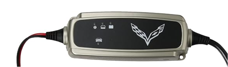

With all due respect, Bill, page 9 of the US 3300 Corvette Model 1051 Battery Charger manual disagrees.

Nortonco:
Is this the same as the GM Corvette Battery Tender (made by ctek)? model 20929740 ?

Originally Posted by C-141 driver
Nortonco:
Yes, that's a CTEK US 3300 Corvette Model 1051 Battery Charger. A copy of the manual, with a diagram of one on the cover, is atchd here.
