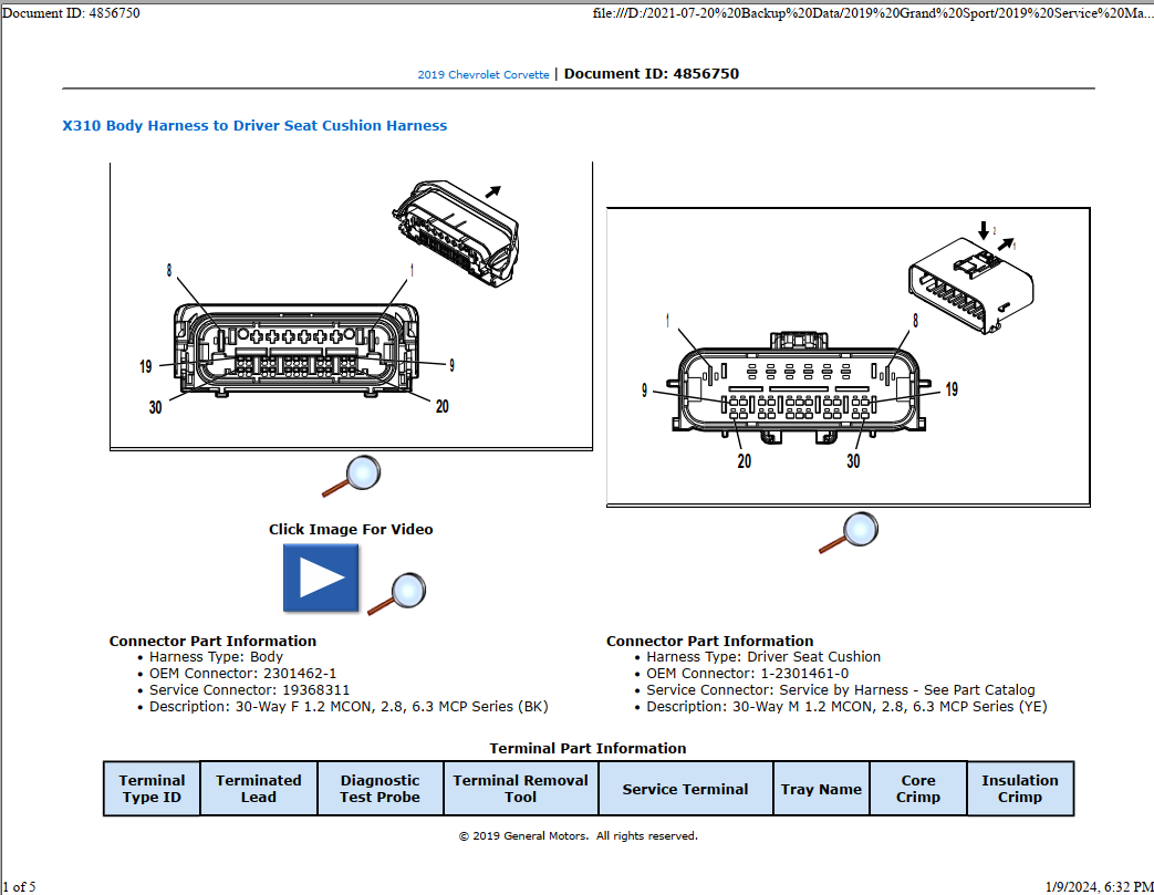

Here's what 2019 looks like (and as I recall 2018) vs the 2014-2017 cars....
Those seats would work nicely in the OPs potential car albeit the module would need to be replaced (and it assumes the trim levels match).

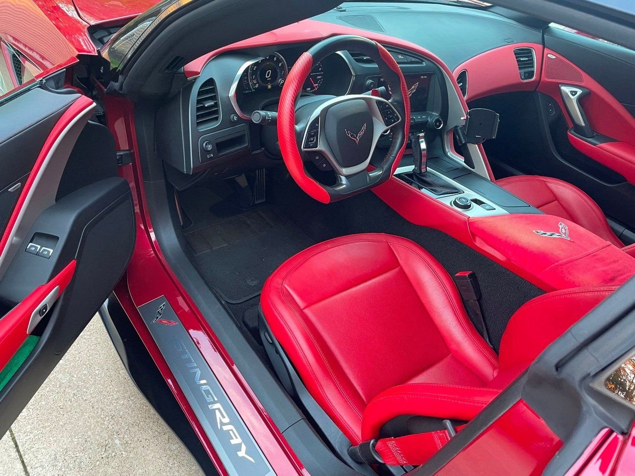

Read these threads for lots of great information:
Added More Adrenaline Red...
and
Adrenaline Red Interior Upgrade
and a little something for motivation:
14point5, how do you like that shifter?

It's solid, feels good in hand, I like it.
