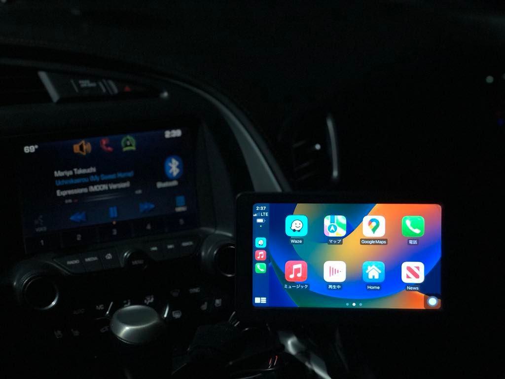

Mine is 2014 so no Carplay from factory. This kind of setup must be the least expensive and easy way to get a Carplay in the car? This screen was $40+ from Amazon and I bought Proclip mount for this device which was another $40-$50.

I was using iPad in the car before but switched to CarPlay screen. In the summer, if you forget to remove or cover it to avoid heat, it gets overheated and non usable until cool down. One down side. Another I would like to mention is icons on iPad screen are rather small and touching action is kinda tough during the driving. This is only my experience.
