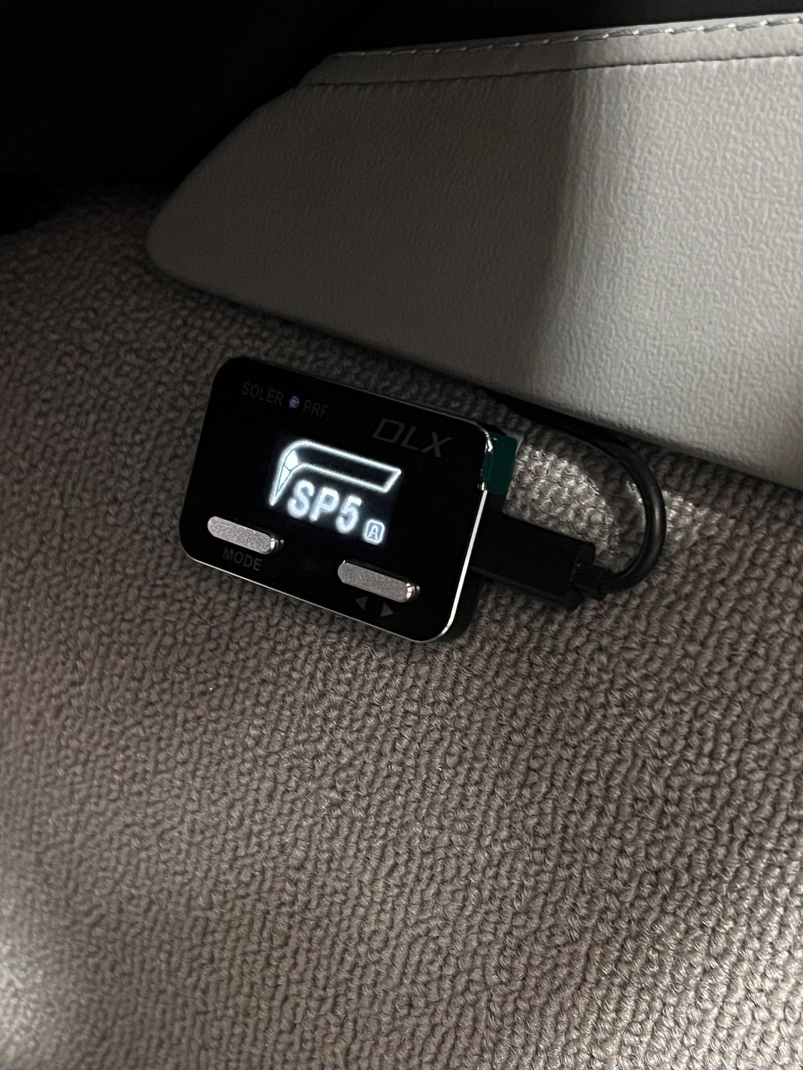

I haven't used the display at all, other than to pair. I did remove the pedal to have enough room to put the module behind the carpet. I have only made changes via the phone app, and after the first day of playing with settings, haven't changed it since. Took me 10mins to install.

I have the display mounted on the side of the console tunnel (held on by Velcro) but once paired to your phone, you can put it away out of sight.

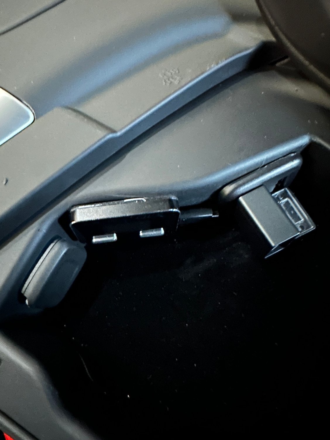

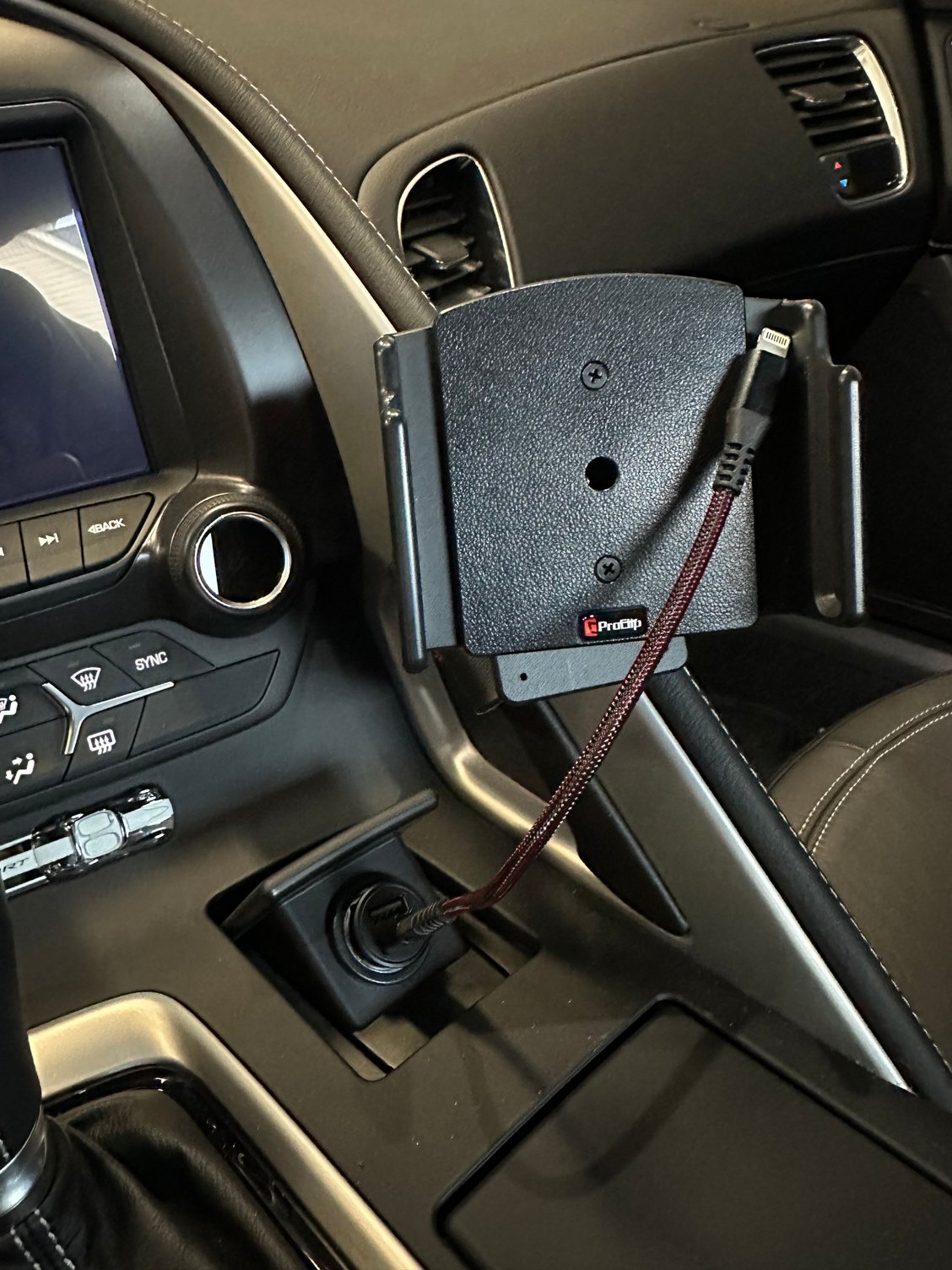

tight space yes. Throttle pedal clip hard to unclip until you realize you have to push down on the flat part of the harness clip. Trim piece on drivers side of center counsel is easy to get off, start in the middle and work your way back towards the rear of the car. Once all the clips are disengaged. You can to the front clip by pulling out and back towards the rear of the car. Putting it back in start at the front and slide it forward as there is a little hook on that end that goes in first and once you do that the clips line up all the way down. I mounted my display unit in the center counsel area between the cigarette type of plug and the usb port connector. I removed the USB connector from the center counsel. It takes a bit to work it free from the square hole. There is not a lot of extra wire with it so you can only pull it out maybe an inch. I used a zip tie taped to the display wire connector to fish it through to the usb square hole. I used a drill bit to create a half circle groove for the display wire connector to sit in and provide clearance for the usb plug to be able to slide back into place. The display wire is just long enough to connect the display in the area of the center counsel between the usb and cigarette lighter type connector in the center counsel. Peel off sticky tape and attach. Perfect location. I have one of those usb plug in devices that allows you to wirelessly connect you CarPlay from your phone which I mounted using one of the pro clip phone holders. I have a super short cord coming up to it to charge it. It’s actually a pretty slick set up. Anyway I can’t of course do two blue tooth devices connected at the same time. So I do have the Soler app on my phone, but the CarPlay wireless adapter takes over and auto connects when I start the car. I wasn’t going to mount the display, but the competing need for wireless car play and Soler app forced me to just mount the display. I’m kind of glad I did anyway as the install looks pretty sweet and hidden away out of sight until you open the center counsel. I will take a picture and upload it after I post this so you can see the location and the wireless CarPlay which I highly recommend. I have learned so many install stuff from this forum. I just did the blend mount and wire tap power for the radar detector. That was way easier than I thought, and once again I knew what tap wire went where based on researching on here. This place is not only fun, but educational…who would have guessed 😂. Pictures coming soon.
