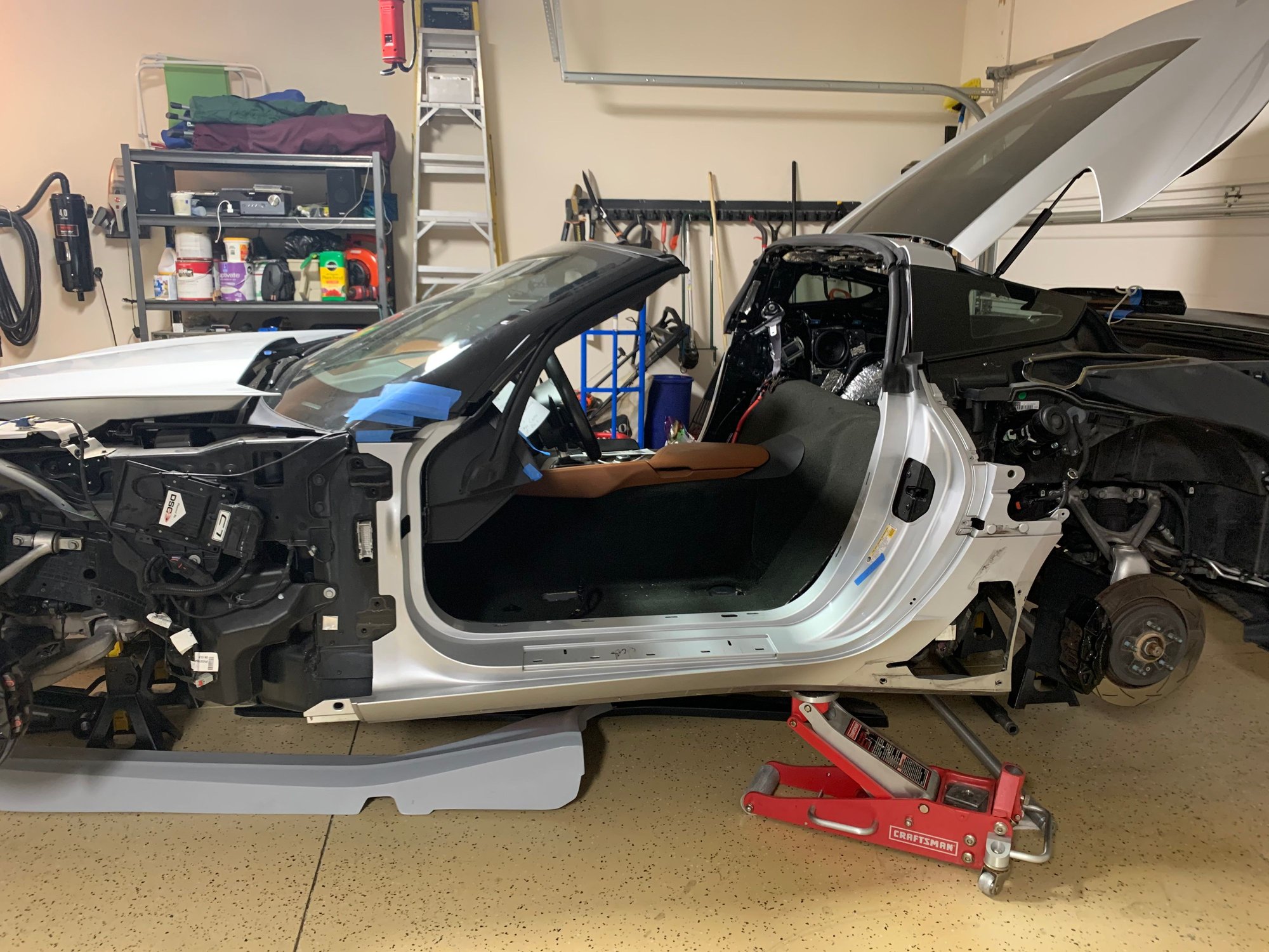

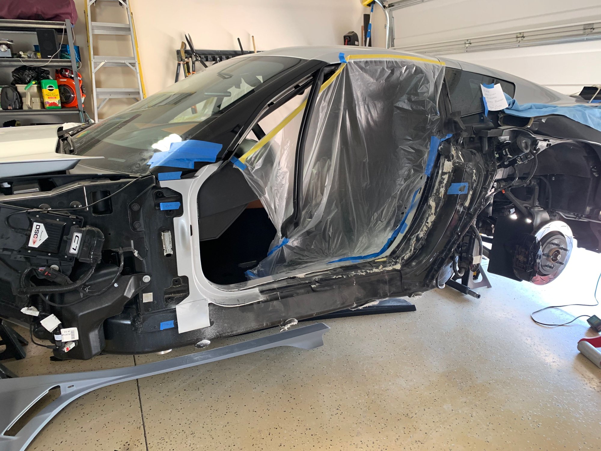

I think it would be impossible to remove the aperture panels without damaging them. I used a combination of cutting wheel, multi-tool and heat gun to get mine off. Took many hours too.

Well thanks man. I really appreciate that.👊🏼 I too heard comments along the lines of "Why not trade for a Z06/GS?" My decision was a combination of financial and sentimental value. Have fun and good luck with your mod. It's definitely worth it. Make sure you post your work.
