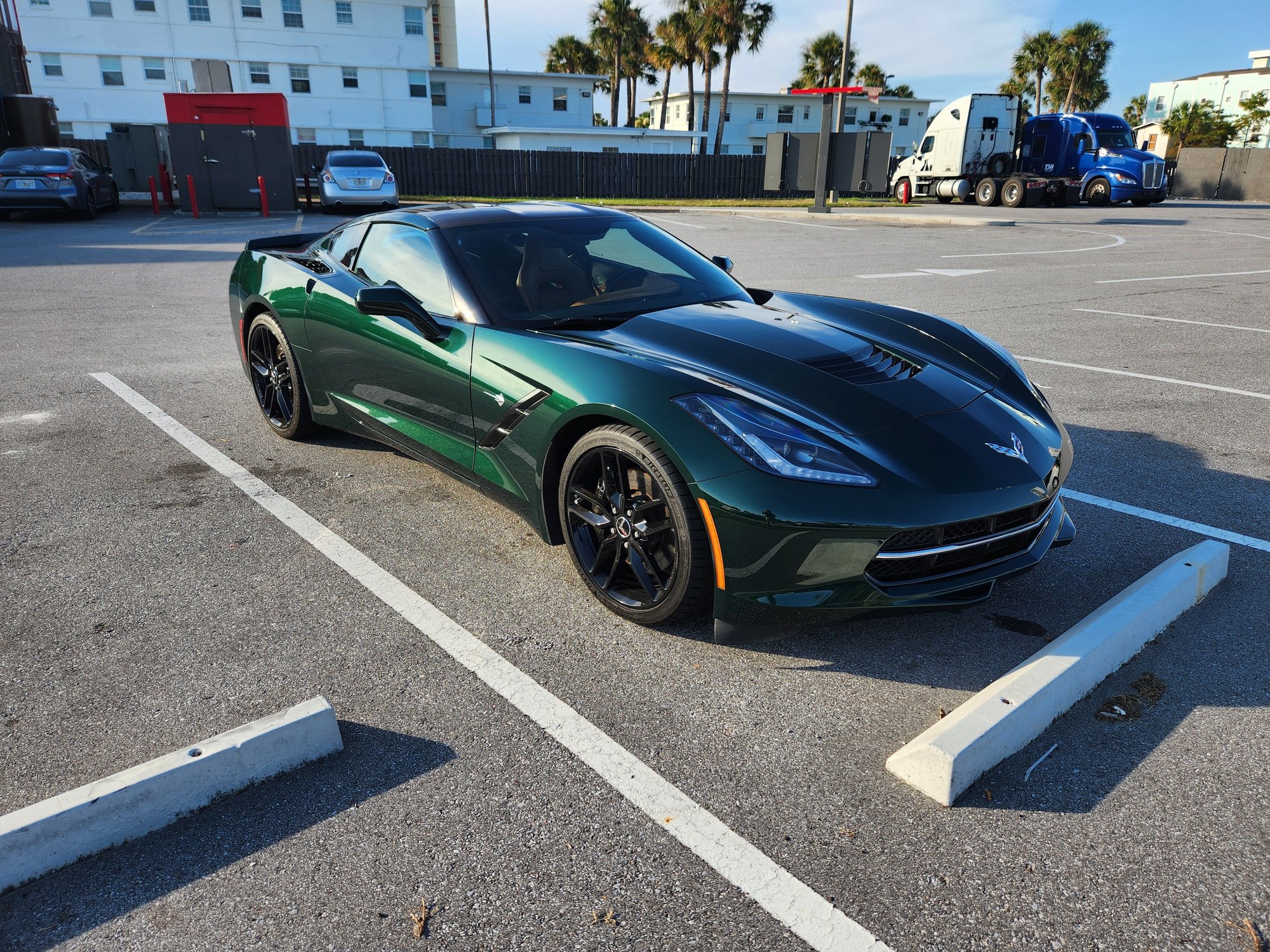

Hi all,
I purchased this Lime Rock Green z51 last year in July and I am looking to upgrade the sound system.
I was Googling and landed on a few posts here listing each component, but it seemed like the recommendations were geared towards audiophiles with large budgets.
I am a sound novice and just want something with more clarity than the stock 3LT 10 speaker system.
Here is what I've gathered:
Lower Door - Kicker 51KSC6504 2-way coaxial
Dash Corners - Pioneer TS A301TW (Are these necessary if I buy coaxials for the lower door? Or should I get a 2-way component system?)
Center Dash - Kicker KSC350
Powered by a Kenwood Excelon X802 5-channel amp.
These parts listed add up to about $475, and I am wanting to stay under a $1000 budget. Is this possible? What other/additional parts do I need?
I appreciate the help.

Welcome to the forum! Gorgeous car, love the color. Sports cars should be colorful! Good luck with your audio improvements.
